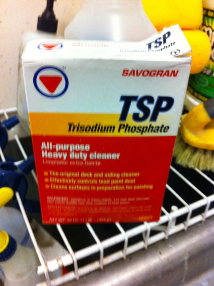

Then soak your parts in a TSP bath as shown in Using TSP to Prepare Parts for Powder Coating.

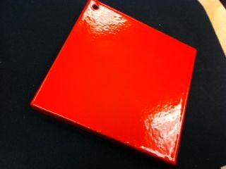

Transfer the parts from the rack to the oven. Latch the door and wait 20 minutes.
Step 17: Remove From Oven After 20 Minutes
After 20 minutes, remove the parts from the oven and hang them to cool down, likely on the powder coat racking. You should have a nice smooth finish at this time.
