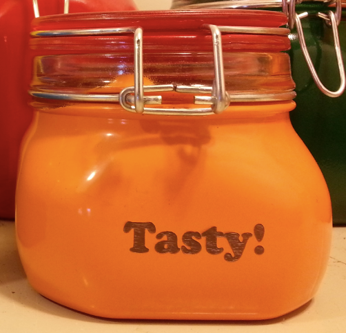

Step 2: Foil-line and Mask Your Piece.
The powder sticks electrostatically to charged metallic surfaces, so we're going to trick the powder into sticking to the glass by coating the inside of the piece with aluminum foil. Make sure that your surfaces are covered without any holes or gaps larger and about a quarter inch to attain an even coating. Depending on the size and shape of your piece, you may need to use some of the heat-tape to secure your foil.
Once you've finished lining the piece with foil, use the heat-tape to mask the mouth and lips very tightly so no powder sneaks in and ruins your piece. When you're masking the mouth, think about the line you're making with the tape as that is the line the color will follow. If you want to mask the bottom or other areas of your piece, do it now.
Just make sure that the metal on the inside of the jar is connected to the metal on the outside of the jar so your conductivity is not impeded.

Step 5: Coat Your Piece!
Now that you've prepared your glass and applied the charge, you're ready to powder coat! Set up your gun and and oven to the manufacturer's specifications and test your spray. Start your spray off of the piece then pull the stream onto your piece once it's consistent. This will help prevent clumping powder on your glass. Apply a thin, even coat to all of the exposed glass that you can easily reach. Then detach the ground if necessary, and rotate your work to access the un-coated side. Re-apply ground and coat again. Repeat until all sides of your piece are coated with a moderate to liberal amount of powder. Take time to inspect your piece for an even coat and keep applying until you have an even, opaque coating. If your coat is heavier in some spots and lighter in others, light coming through the glass will magnify the difference and your piece might not look as nice.
Step 6: Bake It, Cure It, Unmask It!
Once your piece is evenly coated, you can move it to the oven using either it's hanger or it's subsurface. Make sure to move your piece gently and do not touch any of the powder. If you rub it or jostle it, you might need to remove it all and start over. argh.
Place your piece in the powder coating oven and bake it according the the manufacturer's recommendations for time and temperature. I put my my pieces (on their aluminum holding platters) directly on the floor of the oven and baked for about 18 minutes at 385 degrees.
When time is up, remove the piece carefully from the oven using the platter. You can do a second coating of the same color if you see patches in your first coat. (In this photo, you can see that the powder didn't stick, so I did a second coat). You can also do a clear coat if you want to add protection to your final piece. Once you're done with your final coating, remove the piece carefully using the platter or hanging system you made.
The powder is hard and almost finished, but still needs to cure, so it's still possible to mar your finish if you bump the piece on anything or touch it to dry powder coating powder or greasy surfaces. Put your piece in a clean place to cool for about 45 minutes. Once it's cool, remove the masking. Don't do this while it's hot because you risk damaging your coat and it's also a hassle.
Step 7: Congratulations!
Congrats. You just powder coated glass. If you did a knockout job you got a clean piece without any under-coated spots or leaky powder spots. If you did get spots or inconsistencies, you can do another powder coat. You may have more success with a second coat or cover coat if the piece is baking-temp hot when you give the second coat. Once you've done your final powder coat, you can either leave your piece ike it is, or use it as a canvas for laser etching, painting, screen printing, stamping, or most any other common technique. Now reassemble and set it free. Good work!
