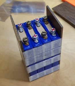

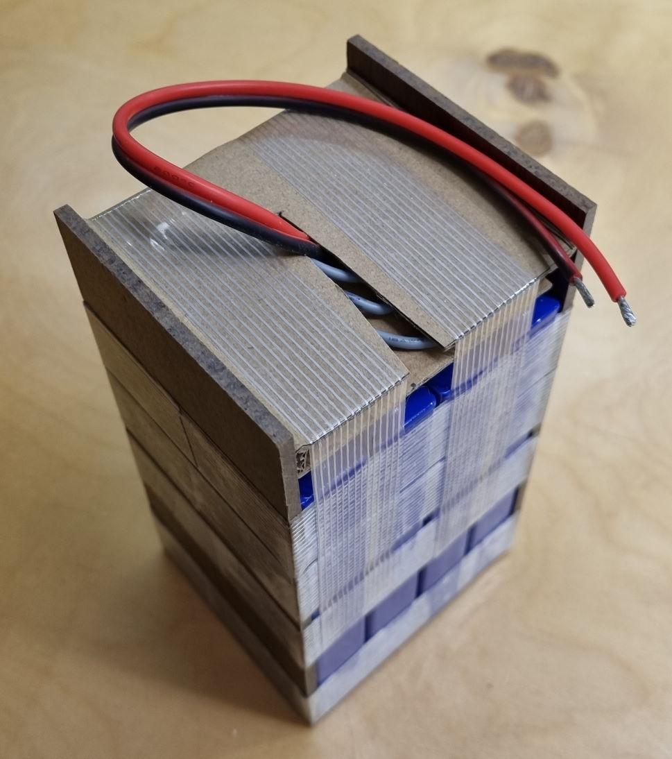

Apparently the LiFePO4 prismatic (identified as rectangular, instead cylindrical, and usually wrapped in blue plastic) cells will expand and contract as they charge and discharge. The general recommendation seems to be to package them in a way to counteract this a bit. In fact, the instructions that came with some new cells I bought recently had specifics regarding how much pressure should be applied. Usually, wrapping the cells in fiber-reinforced strapping tape is sufficient. A thin separator is used between each cell to ensure the metal cases don't touch as a result of wearing of the plastic covers. I use plastic sheets from old report covers, or notepad backing cardboard cut to size. Scrap pieces of .25 inch plywood or hardboard go on the ends. The whole thing is held firmly with quick clamps and then wrapped with strapping tape. Be sure to pay attention to the position and polarity of the terminals. Usually the cell polarity should alternate so that the final wiring in series is made as easy as possible.

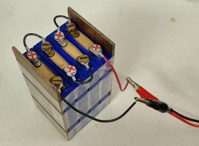

After packaging the cells, I connect them in series and use my 4-amp charger to charge them. Then I use the Atorch battery capacity tester to discharge at what I consider a typical load for my intended uses, about 2 amps. This should take 5 hours.
Charge and Balance
For the balancing phase, I first charge them in series with the 14.6 volt charger. This will stop whenever the total hits 14.6 volts, however, not all of the cells will be at the same voltage, or state of charge (SOC). To achieve that, the cells get reconnected in parallel, and then connected to a constant-voltage power supply set to 3.65 volts. Any cell that is below 3.65 volts will draw current until it's at that voltage. When the power supply is set to constant voltage (CV) it shows the current it is drawing. For me this started around 4 amps and then declined to around 100 milliamps, which is a good-enough stopping point. (The picture shows 3.6V - I later got another charger that allows settings to 1/100th of a volt.)

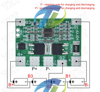

Once the cells are balanced, it's time to install the battery management system (BMS). Follow the instructions for the model you bought. My BMS boards arrived in the mail from China, without any instructions. I went back to the product page on AliExpress and the product description includes a hookup diagram. You can see it in the picture above.
The next picture shows the actual board with connections installed. The main power leads are connected to the P+ and P- pads on the BMS board. The other connectors have appropriately-sized lugs and connect the cells in series. Individual wires go to each cell and are used to keep the cells in balance.
Once all the wires are connected, I use some cardboard with strategic cutouts to insulate the BMS board and then strap it to the top of the battery. Once everything is connected, I run another capacity test until the BMS shuts down. This gives me the total usable capacity.

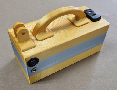

Step 4: Power Bank Assembly
Once the battery is complete, and 3d parts have been printed, it's time to put it all together. It includes:
  • On/Off switch
  • 7.5Amp Fuse
  • USB ports with voltage display
  • 12V plugs for lights, and other devices
  • A case to totally enclose the battery. Some 3mm screws hold the top and bottom together.
  • Mounting point for a lamp so it can be used as a lantern or flashlight
  • Charging plug
  • Handle

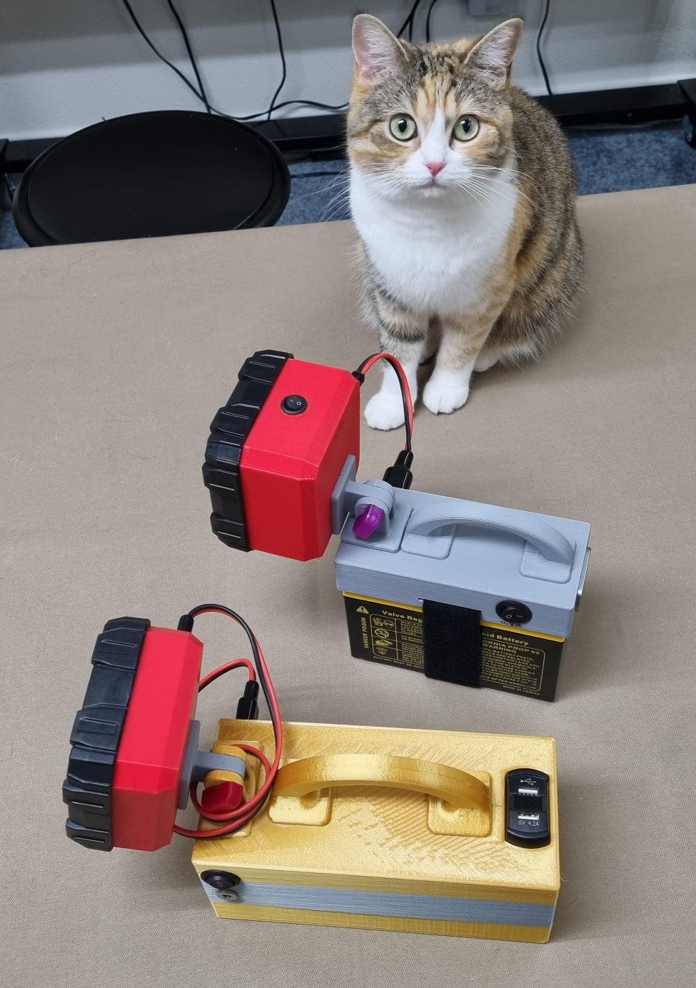

Here is a comparison of the two projects. The new power bank is slightly bigger, allowing for a larger handle, which is more comfortable for my large hands.
I've now built three versions of the power bank, here is how they compare:
UPS 7Ah AGM           Weight: 5lbs 15oz   Capacity: 4Ah      $42
Eco-worthy LiFePO4 Weight: 2lbs 9oz Capacity: 10Ah $40
Custom LiFePO4 Weight: 4lbs 6oz Capacity: 11Ah $Free!
Clearly, if you're starting from scratch, use the Eco-Worthy battery.
I learned a lot about LiFePO4 battery assembly from this project. Thank you to all the YouTube contributors who shared their experience and knowledge. My initial inspiration for this project was my disappointment with the first LiFePO4 battery I bought. I knew these cells would double my capacity, compared to that battery, with only a slightly larger package. Now, this package is only a small improvement over better-quality off-the-shelf batteries, however I have a stack of free cells, and, I'll make a few more power banks, knowing exactly what's inside.
