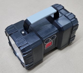

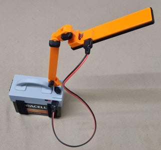

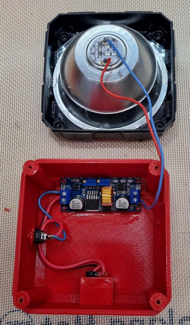

My initial lamps consisted of some recycled LED lamps from a rechargeable lantern whose recharging circuitry got fried. Fortunately, it was put together with screws and therefore easy to dismantle. 3D-printed enclosures contain a step-down voltage and current limiting circuit board, plug, and switch. These lamps are OK, but the beams are too narrow for general illumination. I made another lamp from automotive COB LED strips, and mounted it with some articulating lamp parts.
One thing I discovered is that by aiming the bright LED lamps at the ceiling, it diffuses the light and can provide fairly good general lighting for use in the kitchen, bathroom, and at my desk. The COB LED provides diffuse light works best sitting on a high shelf or atop the kitchen cabinets.
When I took apart the original burnt-out lantern, I discovered it was powered by a pair of 18650 lithium cells. My new lights, using the same lamps, are now powered by much larger batteries, and the whole assembly is only a bit larger, if considerably heavier. The handle makes them convenient to use as lanterns, and the tilt-able lamps are an additional advantage over the original lantern.

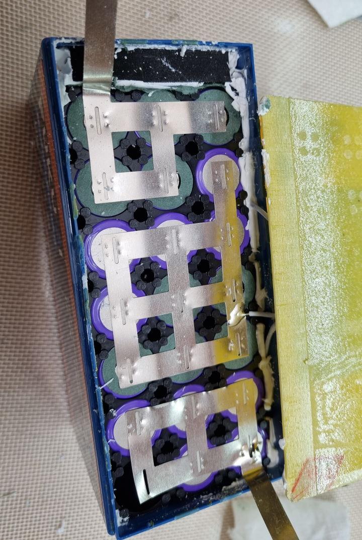

Of course, like any good tinkerer, I took the batteries apart to see what might explain the difference. The first picture shows the inside of the 5.6Ah Fukuai brand. It consists of 20 18650-sized cells. From my use of these cells in flashlights I know there is a wide range in quality and capacity in these cells.
The 9.5Ah Eco-Worthy brand is made up of 8 what look like 26650-size cells. I noticed there is even a temperature sensor connected to the BMS. I still need to test if this is a high or low temperature cutoff sensor. (LiFePO4 batteries shouldn't be charged if they are below freezing.)

The COB LED lights are designed for automotive 12-volt systems and do not include a voltage regulator, unlike my recycled lamps. When I used the COB LEDs with a freshly charged LiFePO4 battery they got warm enough to warp the 3D-printed parts that used PLA. I made two adjustments. I remade the plastic parts with ABS, which has a higher softening temperature, and I inserted a diode into the connecting cable to get a 1-volt voltage drop in the circuit. Most diodes have a .7 volt drop but I found one high-current version that had a 1-volt drop. The voltage drop resulted in a cooler lamp. I use the COB LED with the lithium battery which has a very flat discharge curve. There is little noticeable dimming of the light as the battery drains.
