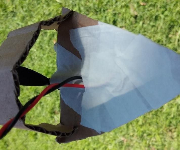

The first cart is made from two motors, used to power a pair of LEDs. The LEDs are not ON at the same time. The second LED is connected in reverse and turns ON when the car moves in reverse.
I also made a bigger cart with more motors to power light bulbs. I was never able to generate enough power even for the 1.5 V miniature light bulb because most of the low cost motors had very poor power generating efficiency. My big cart only worked with LEDs, that need a lot less current than light bulbs. You can see on the photo that I attached 9 dual shaft motors onto a 30 cm ruler.
I am now saving money for more motors to attach to 40 cm ruler.
I needed at least 0.3 amps current. This is why I used so many motors. However, testing showed that I only needed one motor to generate 20 mA needed for my big LEDs (small LEDs only need 5 mA). This is how I was able to implement the smaller cart.
Do not connect the motors in parallel. You need to connect the motors in series. If one motors can generate 20 mA of current as shown in the testing video then 12 motors will be able to generate 240 mA (20 mA * 12 = 240 mA) of current. This is almost the required 300 mA for the 1.5 V light bulbs.
If you look closely at the photo you can see that some motors have a longer shaft. That means you can put motors with shorter shaft in between to save space on your ruler, thus eliminating the need for purchasing a longer ruler. Thus you might not need to use a 40 cm ruler.
You can use batteries to test your motors. However, you can also do this by spinning the wheels with your fingers as you see in my video, in the testing step of this article. If you apply power to motors then they should all spin in the same direction. Motor spinning in an opposite direction will offset the generated voltage magnitude when you drag your cart on the floor.
