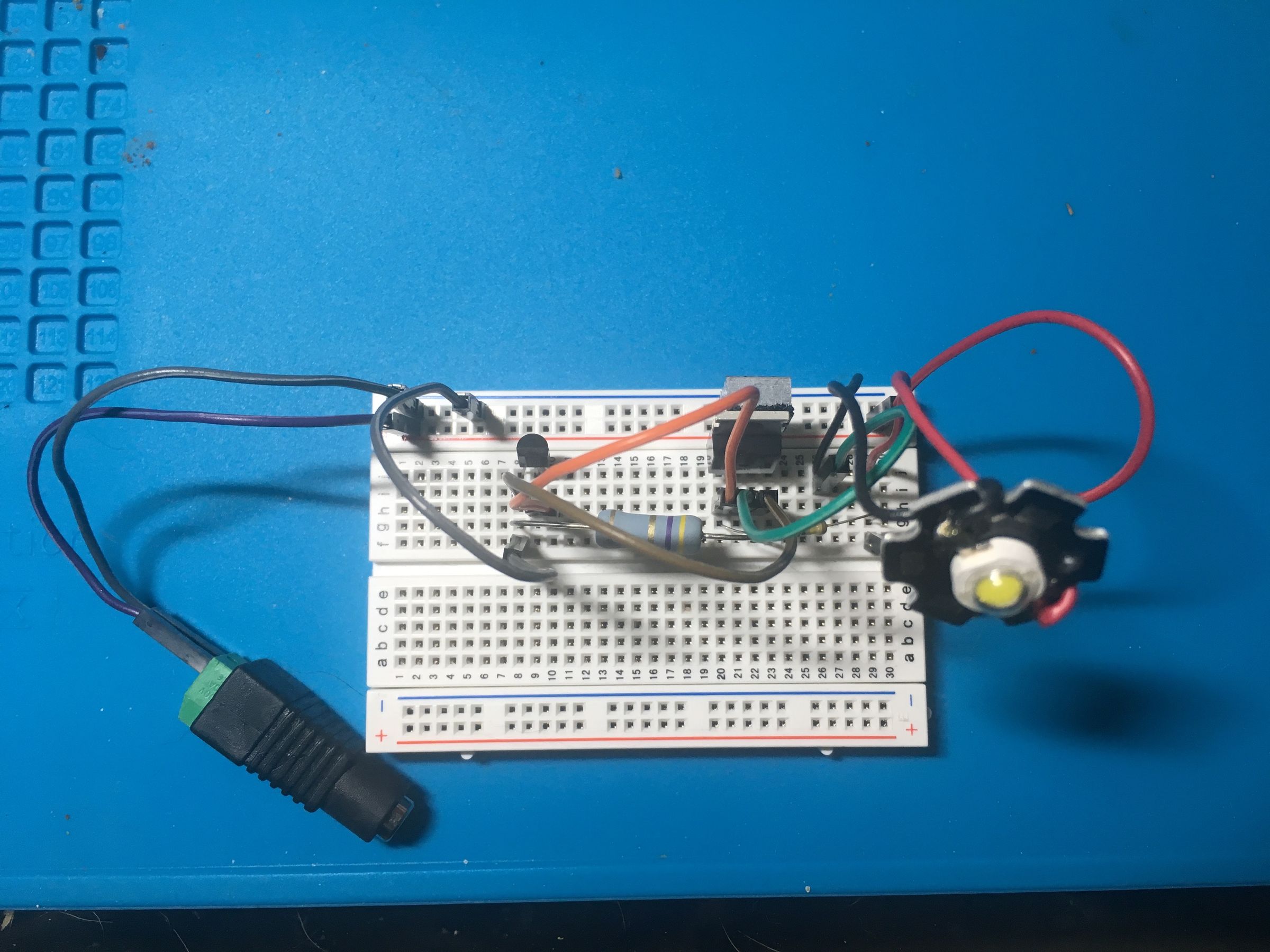

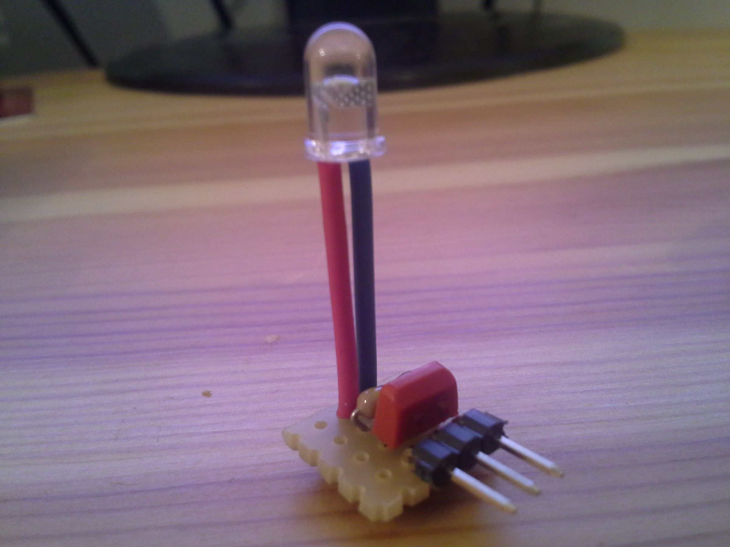

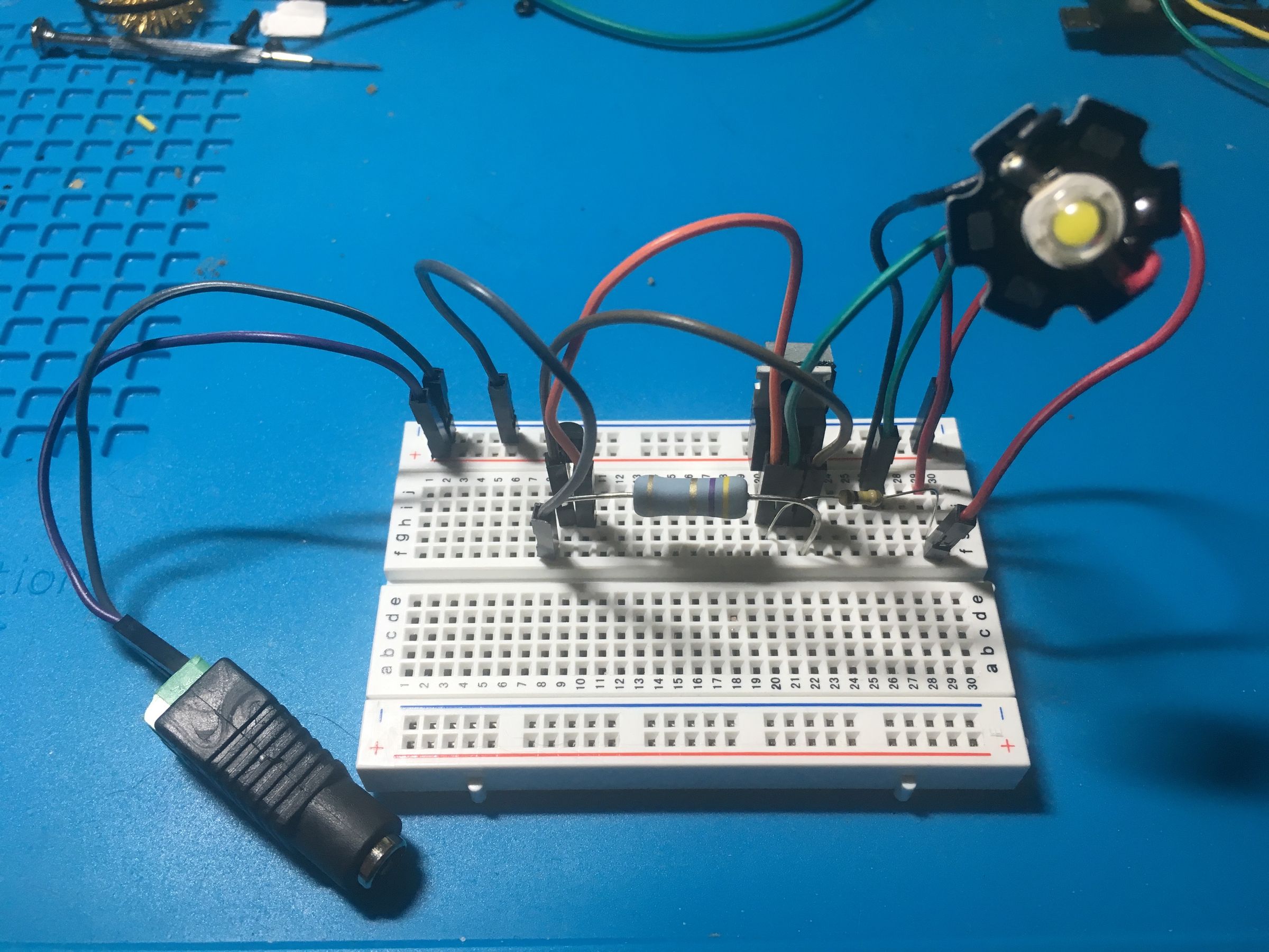

Does anyone have a diagram on how to make this on breadboard? please.
0
daverooneyca
daverooneyca
Reply 1 year ago
I don't have a diagram, but I do have these pics after building this project yesterday.

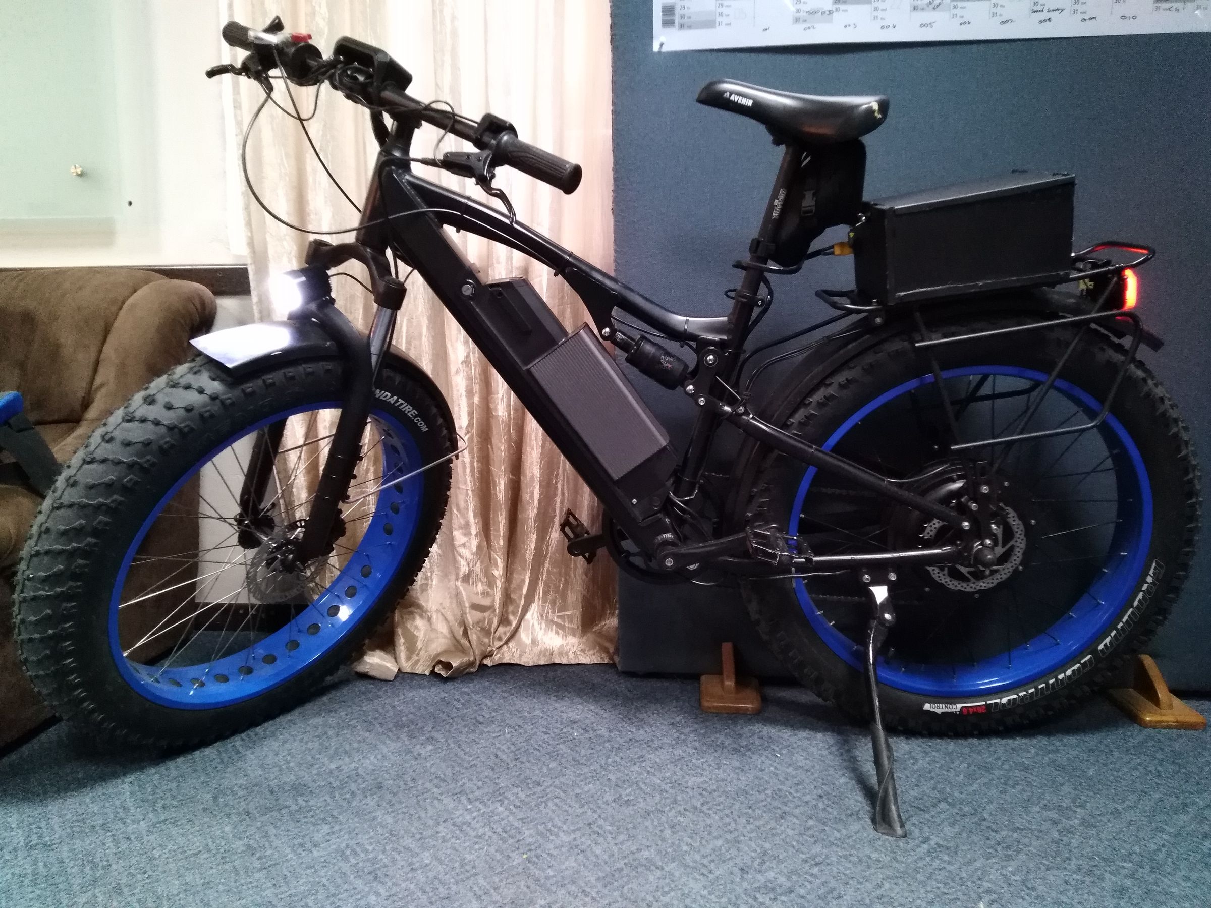

Hi Dan.
I have a question.... I am from Namibia in Africa so please don't ask me to source something I have to get in America or EU.....
Now to the question, I have an Ebike that runs on 48 to 90V (that's what the controller can do...).
I have a front light that works on 9 - 85V so that was a good find I wanted a rear Led light that had an angel and main light in it that runs on the same voltages. They did not pitch after 4 months of waiting. so I have been refunded.
I now need to make a rear light that can also react to my ebrake, so a tail or park light that goes to full brightness once the ebrake is pulled....... I know.. complicated.....
I do not like having a bunch of dc dc convertors as this is just another thing that can go wrong.... I have a few of these cob style led roof lights that run on 12v I have strung 4 in series and put in a fairly high wattage 1.5K resistor and have with success run it on 85V with nothing burning out.....
Is it possible to use your circuit and adapt it for my voltage range? I also do not want to use an Arduino on the bike for the above mentioned reasons....
Any help will be appreciated..

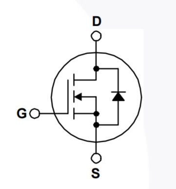

chinmoy1955
chinmoy1955
4 years ago
Congratulations on a simple but effective constant current circuit.

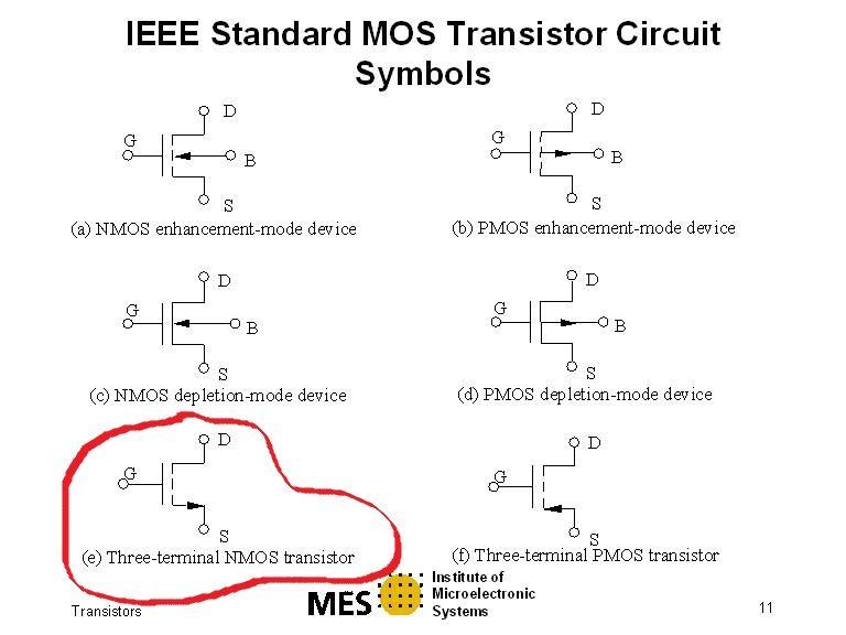

The schematic symbol of the MOSFET shown in the circuit diagram is that of a P-Channel MOSFET, not N-Channel. Moreover, it is not a simple FET but a MOSFET.
The power adapter voltage can be calculated as follows:
V supply = 3.2 X n + 1V
Where 3.2 is the voltage drop across each led, n is the number of LED's in series.
The 1V added in the end is to take care of any voltage drop that may occur in the power supply due to regulation errors. So a 6V supply can only feed one LED. A 12V supply can feed a maximum of 3 LED's. From the above rough formula we can say that 3 LED's in series will require:
V = 3.2X3+1 = 10.6V
So a 12V supply will also work with 3 LED's, but to keep the power dissipation of the MOSFET at a minimum, it would be advisable to keep the power supply voltage as close to the calculated value as possible, thus 11V would dissipate less heat than a 12V supply. So if you have a 24V supply available, you can safely connect 7 LED's in series.

chinmoy1955
chinmoy1955
Reply 4 years ago
You are wrong, the symbol is that of a P-Channel MOSFET. Below is the actual symbol of the Fairchild FQP50N06L MOSFET taken from their data sheet. Please be informed before commenting:
0
simpletronic
simpletronic
Reply 4 years ago
Both symbols ( yours and the author´s ) are correct and correspond to an NMOSFET. The authors´s symbol is a simplified symbol which does not show the internal bulk-source connection. IEEE(Institute of Electrical and Electronics Engineers) accepts this symbol as a validNMOSFET symbol. Nothing more to say.

chinmoy1955
chinmoy1955
4 years ago
I had posted here about 8 months back about a serious flaw in the circuit diagram and related text. I am surprised to find that the original circuit is still being published without correcting the flaw. It seems the author does not bother to read the comments and the people following the post are also as much blind and misinformed as the author.
I would like to once again point out the mistake. The circuit symbol of the MOSFET shown is that of a P-Channel Mosfet, and not N-Channel as written in the article. But funnily, the part number given is that of a N-Channel MOSFET. The proper symbol for the MOSFET mentioned in the article is given below:
