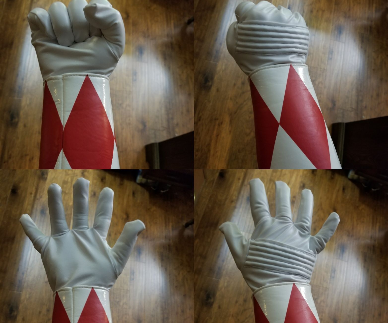

A little over a year ago, I made some Power Rangers gloves. That Instructable is here. They turned out okay, but there was much room for improvement. I learned two things. First, I learned that I am not that great at making gloves from scratch. They fit a touch too small, and looked all wonky when they were not on my hands. Second, I learned that I should have sewn the cord panel to the inside of the glove, rather than the outside. I made a second pair, and this time, made a cuff in the proper length. Remember that, when following this guide, you will need to do everything twice (once for each glove).

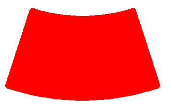

With a measuring tape - measure the circumference of your wrist, the circumference of your forearm where you want the cuff to end, and the distance between those two points on you arm. Find a cuff shaped pattern (you may use the one from here) and modify it to closely match those measurements. Print and cut out the pattern (or use a cutting machine if you have access to one). Using the pattern, cut the shape out of scrap material to test fit the cuff. Leave a little bit of extra, as the size will slightly decrease from your pattern in the next few steps. You will also need to leave enough space for the cuff to overlap itself about an inch (this will be taken in from the seam as well as the hook and loop fastener.)

Using the patterns you made - cut out two each of the leather or faux leather material for the shell of your cuff, the interfacing, and the lining material.

Using cardstock, cut a pattern for your diamonds. I prefer to do this with a cutting machine for precision, but this can also be done by hand. The size of the diamonds is personal choice, and will vary based on length of the cuff. The important thing to remember is that you will need four diamonds. Cut one of the diamonds in half to go on the overhang. Line up your half diamond with the edge of the overhang and determine where the midpoint of the diamond will fall. Mark lightly with a pencil. Repeat this on the other side. Line the bottom edge of your cuff pattern with these two marks and lightly trace the edge of the pattern. This will give you a guide to line your diamonds up. Going inward, line each diamond up until you have five diamond pieces (for a total of four complete diamonds) on the cuff, and tape them in place. As you add pieces, lightly mark where the edge falls. A little bit of overlap is okay, but you may want to resize your diamonds to fit perfectly. Close the cuff up, and you will get some idea of what your cuff will look like completed.
Step 12: Make and Add the Diamonds
This step will repeat most of the same process as the last step, which was intended to help determine what size your diamonds needed to be. Using the diamond patterns from your previous step (or digital pattern for your cutting machine), cut the appropriate size and number of pieces out of glossy, permanent adhesive vinyl in the color of your choice. Remember that you will need twice as many pieces out of this as you do the pattern pices as you are making two cuffs. You may chose to cut an extra diamond and test adhere it to a scrap piece of your outer cuff material. Line up your diamond pieces with he pencil markings made in the previous step, again going from the outside in. Use a brayer or even a credit card to smooth out the vinyl as best you can. Repeat the process for the other cuff and you are done. Great job!
