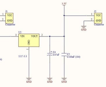

This is kind similar circuit that the Arduino Uno board used for his external power supply. so let's take a look of each part.So firt at all We can supply this pcb with and external source between 6V-18V aproximately, with 9V will be fine. As we can see we connect a diode 1N4004, this is a protection in case that We connect wrongly. After our Protection we can see the chip 7805, very famous and very use.
Now in this part of the circuit We continue with the regulations but with the chip 1117-3.3V, this is the same chip that the Arduino boards use. so we can consider this chip also for anothers projects.

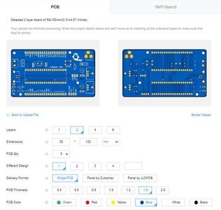

Here after we finish the pcb layout We can get the Gerber files, there are two kind of gerber files we have to pay attention to it, the first GerberX2 and the other Gerber RS274X, most of the manufacturer use the second one Gerber RS274X, in some software we will just GerberX2 and Gerber (In the case of Altium Designer).

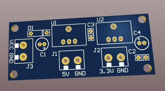

One of the features of Altium Designer is the 3D visualization, the 3d visualization is important and it give us the posibility to see and check our PCB and how it would be in real, also it can show us the components distribution and dimensions.

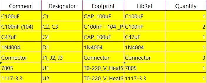

Attached you will find the BOM (bill of materials) needed to build the PCB, as you can see in the list you can the designator that You can check also with the schematic circuit.
