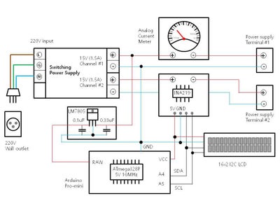

Step 1: Schematics
Basically switching power supply module should be connected to the house 220V wall outlet.
As the electrical wiring method to the house wall outlet is different for every country, please refer to the domestic electricity handling standards of your country.
And please carefully connect three live wires (Neutral, Line, Grounding) to switching power supply input terminals.
As this is a simple power supply circuit, only several components are used for making the final device.
The main goal of this device is to support two channels of power supply outlets equipped with analog and digital current meters.
Only the analog current meter is connected to one side of the 15V power supply channel.
As the analog meter is embedded in an inline style to the output channel, the current drawn from the connected circuit is immediately shown by the needle of the meter.
Meanwhile, the INA219-based digital meter circuit is connected to another 15V channel to show the current flowing into the connected circuit on the LCD.
As the Arduino pro-mini requires an exactly regulated 5V power supply to RAW and GND pins, the LM7805 voltage regulator circuit is used.

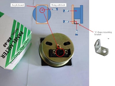

The most important part of this project is the analog meter.

Quit a long time ago (Maybe more than 5 years ago) I bought two analog meters rated as 1A and 2A.
The 1A analog meter is utilized for the power supply circuit which is explained in this story.
The other 2A analog meter is shown in the pictures above.
The usage of an analog meter is not complex as the meter can be simply embedded into hot power wire (Plus polarity terminal) between the power supply and load circuit as shown in the schematics above.
But mounting and fixing the analog meter is difficult as the shape of the meter body is round.
Using acrylic board, “L” shape bracket, and bolts, the analog meter is firmly mounted and fixed on the power supply chassis as shown in the pictures above.

Along with INA219 current sensor break out board, the I2C 16x2 LCD module is sharing SDA and SCL control lines by connected together to the A4 and A5 ports of Arduino pro-mini board.
