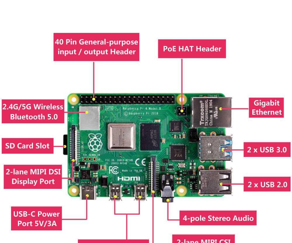

Introduction: Power-off Button for Raspberry Pi
The Raspberry Pi is a very useful computing platform that allows creating various IoT/robotics/smart-home/... project applications. The one thing it doesn't have though, compare to a normal computer, is a shutdown power-off button. So how can we create one ourselves? Alright, let's do it together!
