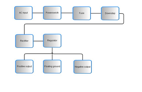

Step 3: AC to DC Conversion Block Diagram
A basic functional block diagram of a power supply with AC to DC conversion.

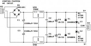

Step 4: Dual Polarity Power Supply 78-79xx Series
This power supply is very simple dual power supply. With using 3 terminals voltage regulator, it’s best and simplest choice for non-critical applications. 3 terminals term is for input, ground, and output. The 3 terminals voltage regulator here are 78xx & 79xx IC (integrated circuit) series that can provide up to 1A load current.
This voltage regulator IC series have on chip circuitry to prevent damage in over heating or excessive current conditions. If the conditions happened, the chip simply shuts down rather than blowing out. These regulators are inexpensive, easy to use, and they make it practical to design a system with many PCBs in which an unregulated power supply is brought in and regulation is done locally on each circuit board.
This Dual Linear Power Supply provides a dual polarity power supply. It can be build easily for delivering up to 1 ampere with the appropriate choice of center tapped transformer and 3-terminal voltage regulator pairs at +/- 5V, +/- 9V, +/- 12V, and so on.
The 3-terminal pair of regulators you want: 7805 & 7905, 7809 & 7909, 7812 & 7912, 7815 & 7915or 7818 & 7918. The + and – regulators do not have to be matched: you can for example, use a +5v and -9V pair. However, the positive voltage regulator must be a 78xx regulator, and the negative voltage regulator a 79xx one. The user must choose the pair he needs for his particular application.

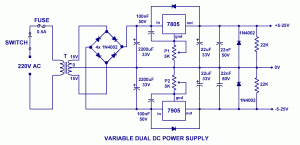

Step 5: Variable Dual DC Power Supply
Here is a simple dual dc power supply constructed by using regulator IC 7805/7905 which provides symmetrical voltage 5 to 25VDC.
An improvement would be to replace thew regulators with a pair of variable IC regulatorsLM317/LM337.
It is advisable to use the IC heatsink.
Variable dual DC power supply is capable of providing current of 1A per polarity. When using a transformer CT 2A power supply for 15V or more output currents can be well distributed. Use fuse size 500mA to prevent damage to components due to a short-circuit.
As we can see both these circuits use a floating ground from the center tap of the step down transformer. Since we are using a power supply which has a step down transformer we would like to avoid redundancy.

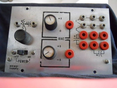

Step 7: After All
With the combination of these notes I was able to get a 18VDC wall wort to split into +/- 9 Vdc which also ran in parrallel with a variable step down LM circuit to get my 5 volts, which was enough to test out the basic functionality of the Paia 2720 modules.
Next consideration will be current consumption, but that is another lesson...
