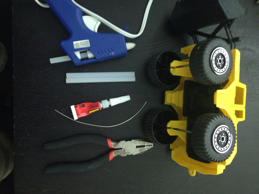

Here are the things you'll need to complete the build
- Old CDROM drive
- Toy car from a dollar store
- Screw driver
- Pliers
- Hot glue gun and hot glue sticks
- Super glue
Electronic components, which you can find at your local electronic store like Radioshack.
- 2 AA batteries
- Battery Holder, when you buy one of these try and get one with an ON/OFF switch
- Solder
- Soldering Iron

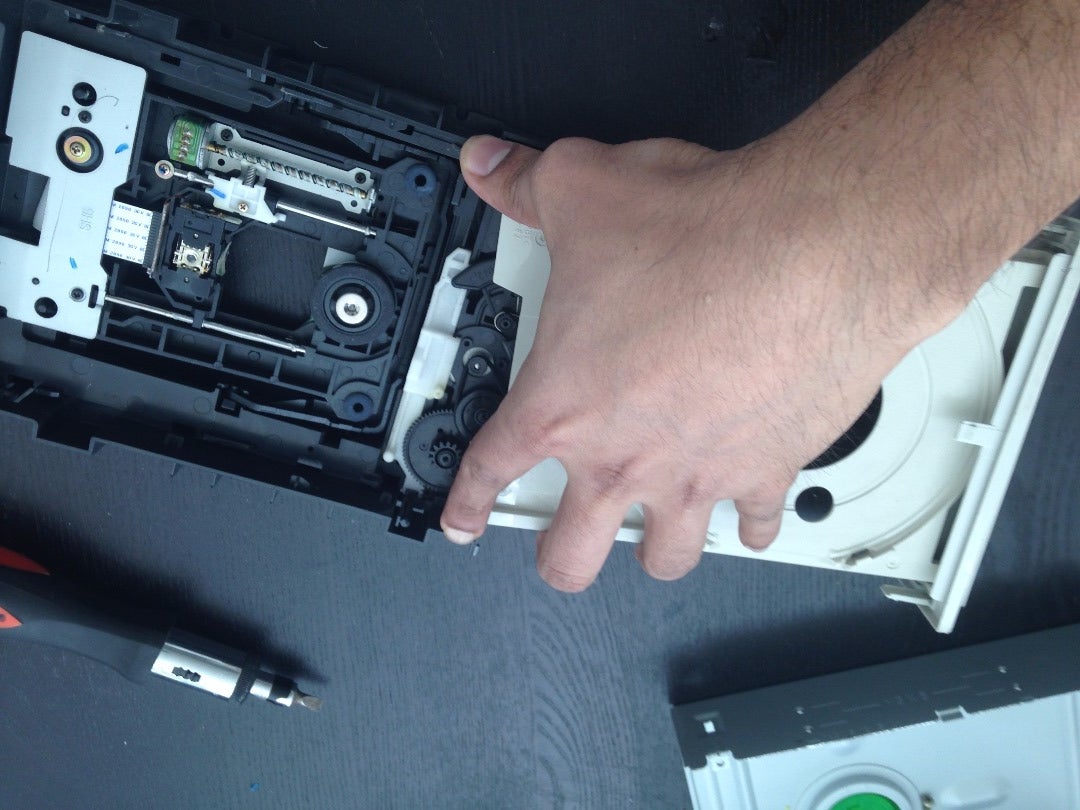

To salvage the CDROM door Opening mechanism , unscrew the 4 screws on the lid and pop it off.
Now you should see a couple of screws attaching the PCB, unscrew them and using scissors cut of the white cables as shown in the picture above.
Put the PCB aside and turn the CD drive over to test the door opening mechanism.
Step 3: Test to Check If the Gear Motor Mechanism and Desolder the Pump
Have your toe fingers crossed !! and test the door opening mechanism as shown in the video above by moving the tray up and down, ensure that the gears and the pulley mechanism move freely.
Now if your mechanism is functional, remove the CDROM tray by unlocking a couple of hinges at the side
Fire up your soldering Iron and desolder the motor from the PCB as shown in the picture above. In my case i managed to break the PCB while trying to pull it out.
Step 4: Saw Out the Door Opening Mechanism
Now using a saw , cut through the plastic just above the CD door locking mechanism and the joint at the side as shown in the picture above.
Be patient !! and Ensure that you do not damage the other components as you can build more awesome things out of the other components..

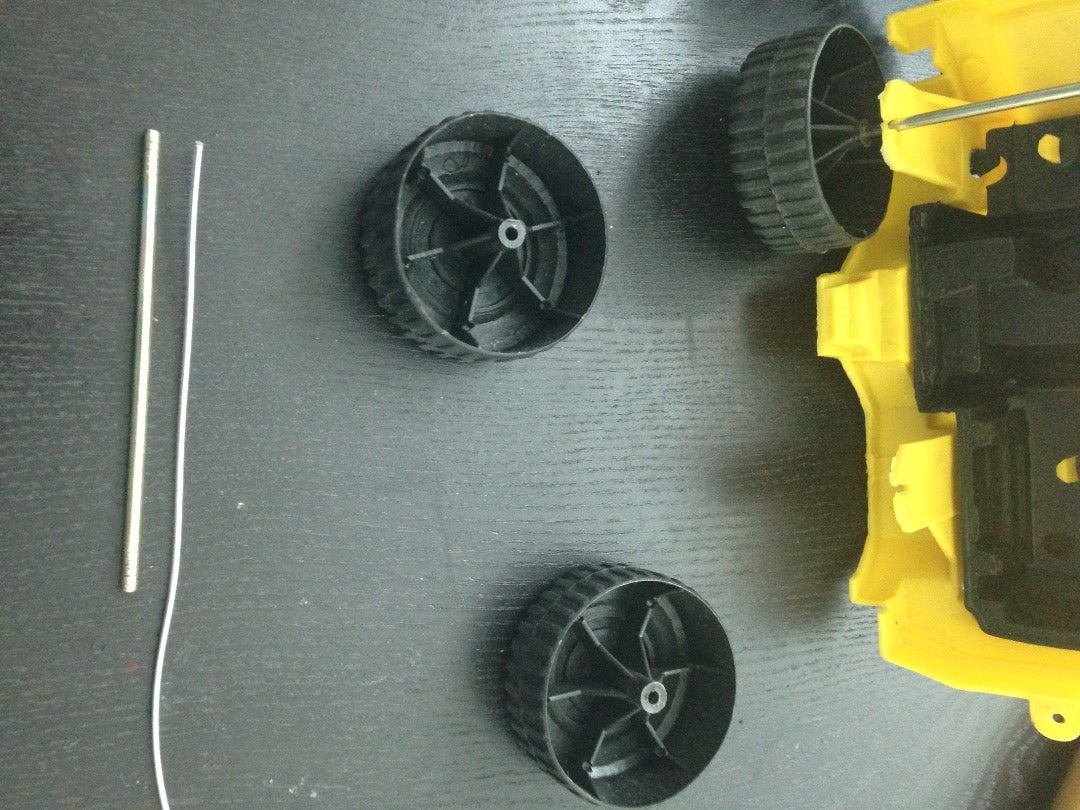

Step 6: Pass a Wire Through the Gear
Get the wheel of the toy and measure and cut a strand of wire as the same size, as shown in the second picture.
In my case here the diameter of the wire connecting the wheel was slightly thicker than hole in the big gear.
Now get the pulley and gear off the door opening mechanism and super glue the gear to the wire at the center as shown in the fourth picture above.

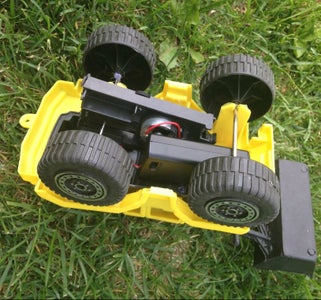

Step 8: Secure the Battery Holder and Door Opening Mechanish
Before super glue the battery holder and the CDROM mechanism decide what goes where.
Now fire up your Hot Glue gun and glue the battery holder to the toy , followed by the CDROM door Opening mechanism. Hold the parts against for a few seconds till the hot glue hardens. You can also use super glue if you dont have a hot glue gun handy.
Congratulations you done!! and ready to take the toy out for a spin.
