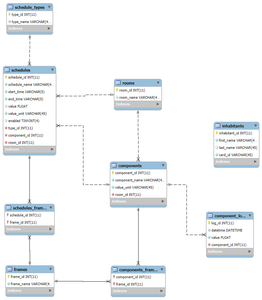

Step 4: Creating the Database
The script to create the database with some data is in the github repo under database -> power_link.sql
What's being stored?
  1. Component logs (the logging is optimized so only values get logged when they change, this prevents the database from being filled with useless data).
  2. Components.
  3. Component pages (this stores which component is shown on which page, this allows for a more customizable application).
  4. Inhabitants
  5. Pages
  6. Rooms
  7. Schedule types
  8. Schedules
  9. Schedule pages (this stores which schedule is shown on which page, for example the fan and heater have a seperate schedule, but the climate control is one. So you dont want to show 2 schedules for 1 control).

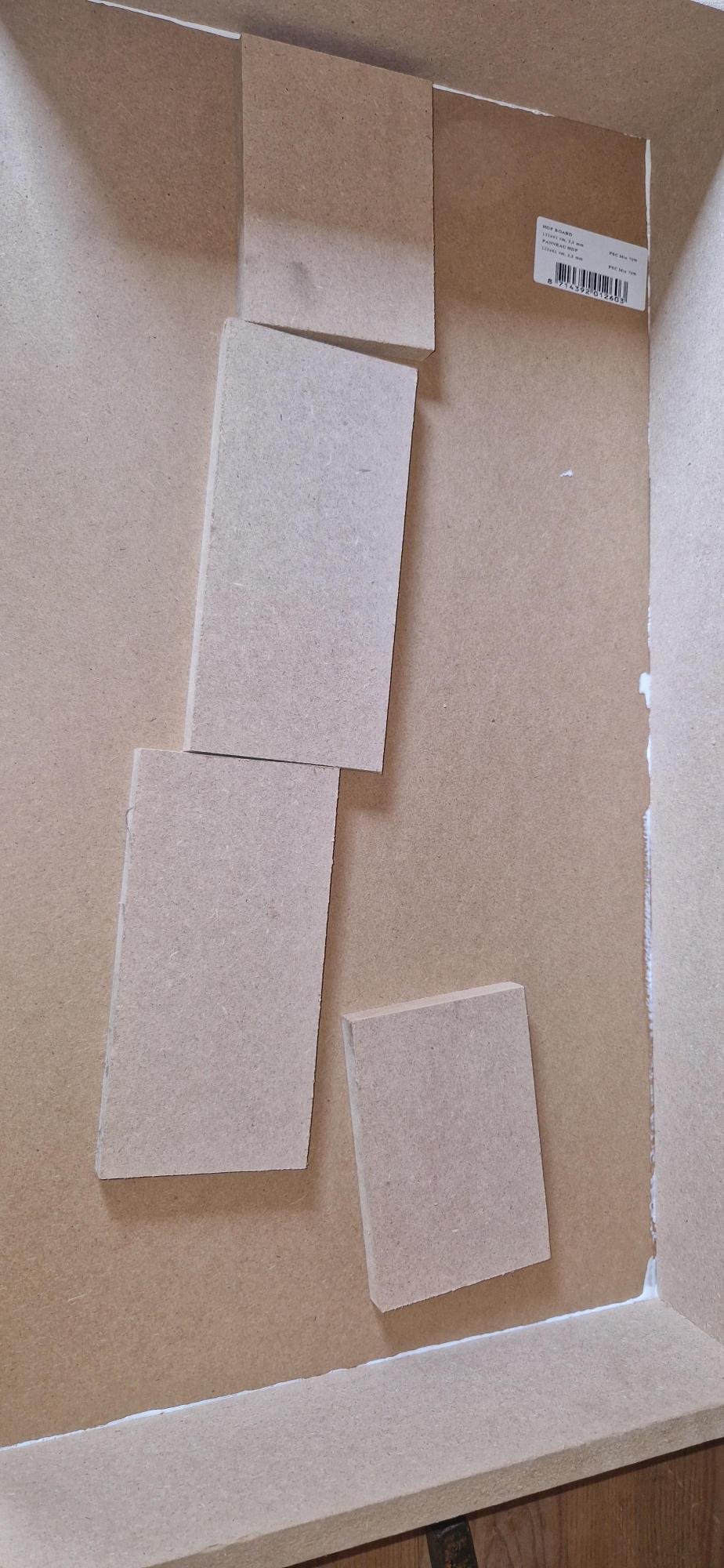

This is the box where the house will be mounted on. I designed it so it’s solid but not too heavy to carry around.
As you might notice, the schematics don’t have holes in the top plate to run the wires through. I left these out because where you drill the holes in the bottom of your house (either the one I bought, another one, or maybe one that you made yourself), might vary. What I did myself: I drilled the holes in the bottom of the house, I placed the house on top of the box once it was finished, and with a marker, you draw through the holes on the top plate. This will ensure your holes match
Step 7: Building Your Home
What tools do you need?
  1. Table saw
  2. Screw clamp
  3. Hotglue gun
  4. Drill with drill size 13mm
  5. Soldergun and solder (in case you want to solder the components insead of using the jumper cables to ensure connection)
  6. Green spray can
Steps to building your home
  1. Saw all planks needed (available on the schematics).
  2. Place all planks together to ensure everything fits correctly
  3. Glue the sides to the base plate.
  4. Place some supports, make sure your components fit between them! (these will support the top plate when weight comes on top of it). I also places the supports close to the door, this will prevent the door from swinging inside in case they get pushed when already closed.
  5. Drill a hole in the side to run your ETH and RPi supply trough.
  6. Connect the hinges to the doors and put some handles, or pieces of wood on them
  7. Spray the top place green
  8. Place the house with the holes drilled in the bottom on top of the top plate, and mark the holes.
  9. Drill the holes with diameter 13mm.
  10. Place the components inside of the house, i secured them in place using a hotglue gun.
  11. Pull the wires trough the bottom of the house and mark the wires with tape, this will be usefull later to connect the components to your breadboard. Instead of a bunch of wires, everything is ordered. This will save you alot of headache.
  12. Place the house on top of the top plate, and pull the wires trough. Then place the top plate on top of the box.
  13. Connect all components to the breadboard and test everything using the code.
  14. When everything works, you can secure the top plate to the box, and the house to the top plate. I did this by the preffered method: using L profiles. But you can glue this as well.
