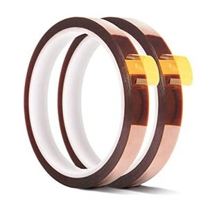

  2. Kapton Tape (used for connecting batteries together)

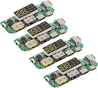

  4. PCB for recharging the batteries, and giving materials power

Using Kapton tape you secure both batteries together; Kapton tape is not required however, you can use your own tape or you can hot glue the batteries together. When you are securing them together make sure to have both sides aligned positive with positive, and negative with negative, etc. Then you will be ready for the next step.

When you are soldering the batteries to the PCB using wire, you must exercise caution as the soldering Iron will become extremely close to your finger. There are two spots in this area on B- and B+. The negative side will go to the B-, and the positive side (red wire) will go to the B+. Make sure to put both sides correctly; if you do it incorrectly, it will create a discharge, and either ruin the battery or the device you are charging. As stated, NEVER FEAR, because the PCB and these batteries have overcharge and discharge protection, but you want to keep in fact to put these the right way because this could cause the batteries to malfunction.
Step 5: Check If the Power Bank Works
Lastly after all this work, (this took me three hours to do for some reason), you will be proud to say that I have built a power bank, something that Charges my phone wirelessly, and effortlessly. Also if the power bank's LCD screen lights up that means you did it correctly! Congratulations.
