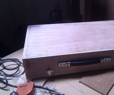

Step 15: Apply a Finish
I used wood finishing oil. Three coats.
Step 16: Assemble
I then put the thing back together and added the handles. Nearly there!

And here we have the finished pedal board, ready to rock.
