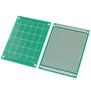

  1. Solderable one-sided breadboard

Step 1: Prepare the Breadboard
Cut the breadboard in square shape.
Apply copper tape vertically on one side leaving some space in between. Also mark one copper plane as + and the other one as -.
Apply copper tape horizontally on the other side leaving some space in between. Also mark one copper plane as 1 and the other one as 2.
