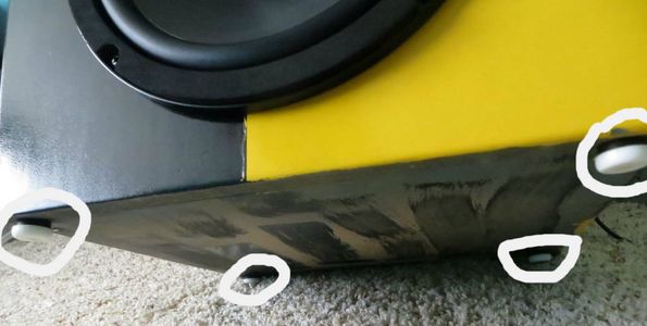

Step 15: Mount the Back Panel and Attach Feet.
If you want really nice sound quality, I recommend adding 1/8" tube foam insulation hot-glued to the box around the edges. That way it makes a nice air-tight seal when you attach it. You may have to add extra screws so that the back panel does not warp when you tighten the screws down. I think it would be fine if you skipped this step, I don't think there would be much of a difference noticed.
I also added feet to the bottom to keep it from sitting on the ground. I found them at Menards for $1.50. This also helps in case the box doesn't sit completely level.
