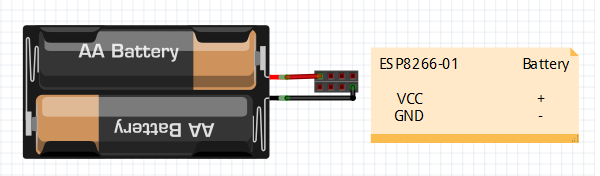

Step 2: The Connection -
Of course the connection is very simple.
1) The Batteries -
+ [| 1.5 volts -- | [| + 1.5 volts -- |
|_________________| |________________|
Connect the batteries in series to get 3 volts.
2) The ESP8266 -
Connect the VCC of the module to the positive of one battery. And the GND of the module to the negative of the other battery.
