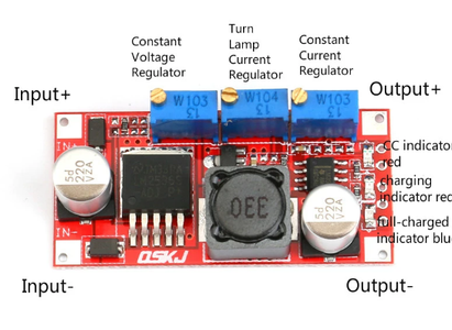

Adjustable DC-DC power supply (DC/DC PSU) - used this one
  • Same as the adapter it must be able to handle the required power
  • Must be able to adapt the voltage of the power supply to your device requirements I was stepping it down to 4.2V which gave me about 60% charge reading.

Turn the charge regulator and constant current regulator potentiometers on your power supply to the max and solder the DC/DC PSU input to your DC wall adapter leads minding their polarity.
Measure the output of the DC/DC PSU and turn the voltage regulator potentiometer until you get voltage in the operating range of your device's battery.

Step 5: Connect the Capacitor Paralel to the DC/DC Powersupply Output
Solder the capacitor in parallel to the DC/DC PSU output mind the polarity.
The capacitor helps even out DC/DC PSU output which is not perfect it caused my device to boot loop.

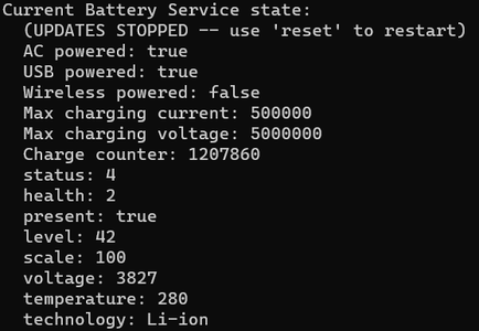

There is no response to these commands in the console, but you can validate it via typing:
adb shell dumpsys battery
The response should look something like the picture. The important part is that AC powered is true, USB powered is true, and the level is set to the number you've picked (42 for me).
