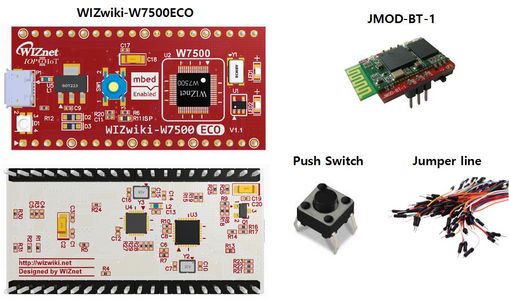

Step 1: Parts
- WIZwiki-W7500ECO : Reference Document, Sale_En
- JMODE-BT-1 : Reference Document , sale_kr
- Jumper line
- Push Switch

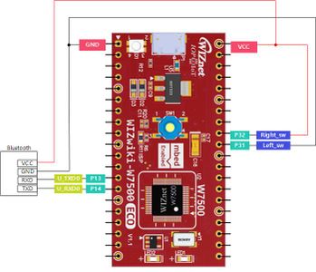

Step 2: Schematic

Step 4: The Sequence of Operations
1. Upload the firmware on the WIZwiki-W7500ECO.
2. Connect notebook and JMOD-BT-1 using the bluetooth communication.
3. Execute the Processing program and insert the source code.

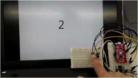

4. Control the slide show of PPT using the push button.
Step 5: Video
