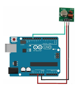

Transmitter module
  1. Communication method: Amplitude Modulation (AM)
  2. Operating frequency: 315MHz/433MHz
  3. Frequency stability: ±75kHz
  4. Transmitting power: ≤500mW
  5. Static current: ≤0.1μA
  6. Transmitting current: 3-50mA
  7. Operating voltage: DC 3-12V
  8. Transmitter head (utilizing 2SC3357 transistor)
Ideal for wireless remote control and data transmission systems with multiple transmitters and a single receiver. SAW resonators offer excellent frequency stability, comparable to crystals, surpassing common LC oscillators. Even with high-quality variable capacitors, maintaining tuned frequency against temperature and vibration changes is challenging. The transmitter module lacks an integrated encoding circuit but features a data modulation transistor Q1, allowing for straightforward integration with external encoding circuits, rolling code circuits, and microcontrollers, regardless of encoding circuit voltage or output signal amplitude. For instance, when interfacing with encoding ICs such as PT2262 or SM5262, simply connect the data output pin (Pin 17) to the data module's input terminal.
Step 4:
The transmission module operates between 3 to 12V, maintaining a stable frequency regardless of voltage changes. Its paired receiver can receive signals without adjustments. At 3V, the module transmits up to 20-50 meters; at 5V, the range is 100-200 meters; at 9V, it extends to 300-500 meters. Optimal performance is at 12V, with a transmission current of 60mA and a range of 700-800 meters at 500mW. Beyond 12V, power consumption rises without significant improvement in transmission range.
This module offers high transmission power and long range, ideal for challenging environments. A 25cm wire is recommended for the antenna. For optimal long-distance communication, position the antenna vertically. Keep in mind that actual transmission distances are typically half or less than the rated distance, so account for this in development.
The data module uses ASK modulation for lower power consumption, with transmission current dropping to zero when the data signal is inactive. Connect the data signal to the transmission module's input using resistors or direct connections, avoiding capacitive coupling to ensure proper function. Maintain the data voltage level near the module's operating voltage for optimal modulation.
The transmission module should be mounted vertically on the motherboard's edge, at least 5mm from other components to prevent impedance issues. Its range depends on signal frequency, amplitude, voltage, battery capacity, antenna, receiver sensitivity, and environment. In open areas, it can reach up to 800 meters, but obstacles reduce this distance. Signal refraction and reflection cause dead zones and instability, resulting in variable distances based on conditions.

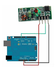

Super-regenerative Receiver Module
Dimensions: 30x13x8 millimeters
Main Technical Specifications:
  1. Communication Method: Amplitude Modulation (AM)
  2. Operating Frequency: 315MHz/433MHz
  3. Frequency Stability: ±200kHz
  4. Receiver Sensitivity: -106dBm
  5. Static Current: ≤5mA
  6. Operating Current: ≤5mA
  7. Operating Voltage: DC 5V
  8. Output Method: TTL Level
The receiver module operates at 5V and 4mA, featuring a super-regenerative circuit with -105dBm sensitivity. A 25-30cm vertical wire is recommended for reception. The module lacks a decoding IC and functions as a basic component, achieving its full potential when integrated into specific circuits and further developed. This design allows for adaptable use with various decoding circuits or microcontrollers, offering convenience and flexibility in circuit design.
The advantages of this circuit include:
  1. The antenna input end features a selective frequency circuit, independent of the quarter-wavelength antenna's selective function. When controlling over shorter distances, the external antenna can be shortened or even removed.
  2. The waveform at the output end is clean without signals, with interference signals appearing as brief spike pulses rather than the dense noise waveforms produced by other super-regenerative receiving circuits, resulting in strong anti-interference capabilities.
  3. The module itself emits minimal radiation, and combined with the shielding effect of the copper foil grounding mesh on the back of the circuit board, leakage from self-oscillation and intrusion of external interference signals are minimized.
Using a skeleton-core copper inductor to set the frequency at 315MHz before sealing enhances stability over circuits with adjustable capacitors. Adjustable capacitors have limited precision and cannot be sealed post-adjustment, as they are prone to changes from environmental factors. Adjustable inductors, however, allow for precise multi-turn adjustments and can be sealed to maintain constant inductance.
