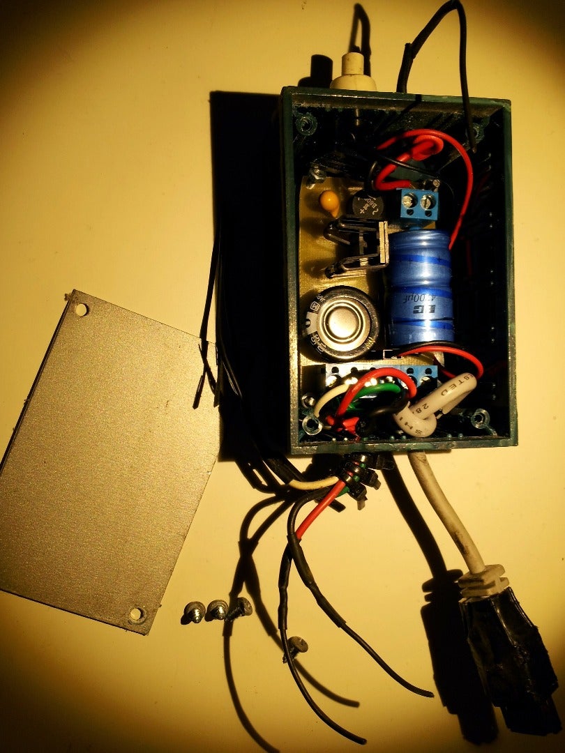

For the lights I took the incandescent light out of my headlight and replaced it with 3 white LEDs. The back light was already LED, but battery powered, so I just wired it up with an extra resistor to keep it from eating power too fast at stops, giving preference to the headlight. If you have an led headlight or taillight, you can use them as-is, just wire up to the battery terminals.

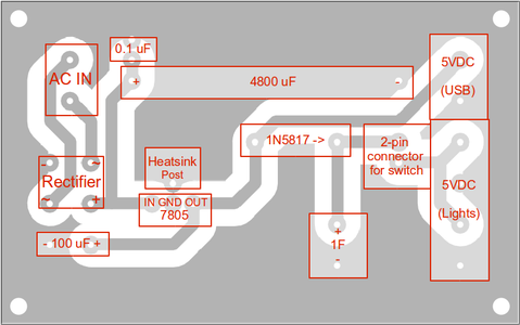

Check Component Fit in PCB

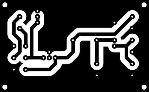

Once you have your parts, print the PCB and make sure they fit - adjust ad necessary. I recommend editing the SVG (link below) with Inkscape or something to tweak the layout as required. Feel free to add labels or whatever to the mask. If you are designing your own PCB with stripboard, keep the enclosure size in mind.

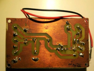

Make and Drill PCB
Some of the components, like the terminal connectors, the supercap and the 7805 usually have slightly bigger leads than the other components (smaller caps, diode), so you may need a slightly larger hole for these in the PCB.

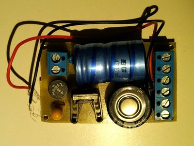

Solder It Up
When soldering in the parts, mind the polarity on the caps/rectifier/diode and be sure the 7805 goes in the right way (IN/GND/OUT).

I like where I put it behind the seat, but your bike and preferences might be different. You should think about how you will wire it up when choosing a mounting location.I used strong zip ties to secure mine to my bike frame and added a piece of black duct tape to blend it in and cover the PCB mounting screw heads.
Wiring It Up
For the wiring you will need to connect/extend wires along your bike frame. Be sure the connections are good and secure - I just twisted the wires together and used heatshrink tubing to secure them. I recommend using heatshrink tubing along the length of the wire along the frame, as the insulation will wear out after a couple months otherwise.
