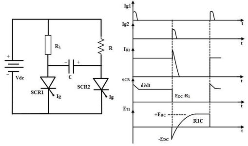

In this commutation method, the main SCR (which is to be commutated) is connected in series with the load and an additional or complementary SCR is connected in parallel with the main SCR. Hence, this method is also called as Complementary Commutation.

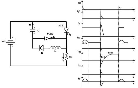

This is also called as auxiliary commutation because it uses an auxiliary SCR to switch the charged capacitor. In this, the main SCR is commutated by the auxiliary SCR. The main SCR with load resistance forms the power circuit while the diode D, inductor L and SCR2 forms the commutation circuit.
