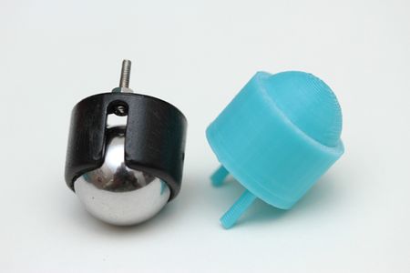

First tidbit, is the translation gap between 3D printed plastic parts and just about everything else. Can you 3D print a ball caster?
Yes... yes you can.

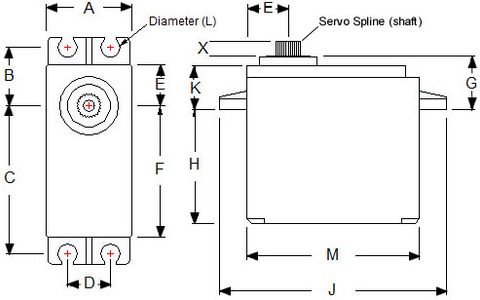

Step 3: Datasheets Are Your Friend
You know that feeling you get when you stumble onto a website that has exactly what you need to finish your semi-sentient bioloid?

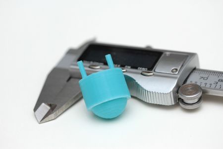

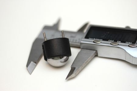

Before you raid your piggy-bank... use datasheets and technical drawings to create facsimiles of the parts in your shopping cart. Large and small, make them all!
"Measure seven times, 3D-print as much as necessary, and buy your final supplies once." - Me

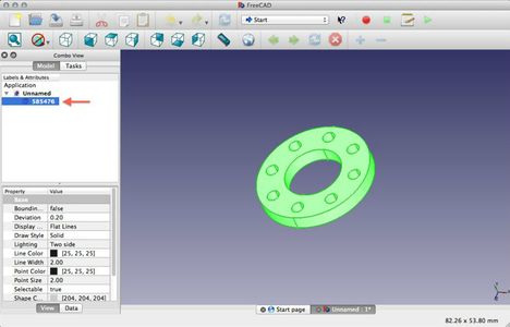

Step 4: Standardize... Everything!
McMaster-Carr has thousands of fasteners, bearings, nuts, bolts, and wibble-wobbles. Gaps in their smaller fastener offerings can easily be filled by Micro Fasteners.
Is there a particular thread / size that can get you through 80% or more of your project? And, while you're at-it, pick a 'system' (metric or standard) and stick with it as much as possible.
Unless you have unlimited time and finances that is... in that case, go nuts!

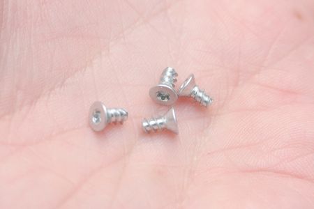

(photos: M3 tapered tap and self-tapping screws)

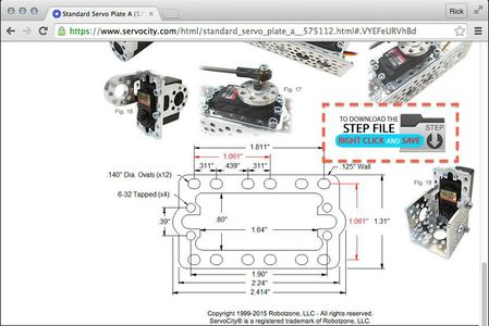

Companies are starting to release mechanical models of their products - that can be used in modelling software or even printed for use in lite-duty proofs / prototypes.
I used the guts provided by Servo City to make Mazinger Z's shoulder joint... take a look!

Warming the plastic a bit and dry-threading a screw into place can help form threads in delicate parts when a tap is too aggressive (e.g. removing too much material). If you need a little more grip, consider using threaded inserts; recycling them back into your parts bin when the printed part has served its purpose.
