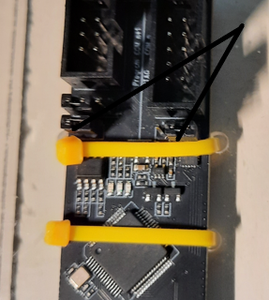

Place your ESP-PROG and mark holes for the cable strips. One of them should be placed, so that it is up against the jumper sockets for power selection to keep the ESP-PROG in place, when you detach the USB cable.
Fix the ESP-PROG and drill a 2.5 mm hole for the stop screw. Cut 3 mm thread and place the washer and and the screw. The washer must be high enough to stop the ESP-PROG, when you attach the USB cable. If you do not have thead cutting tools, drill the hole 3.5 mm and use a nut instead.
