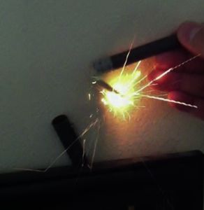

The primary design problem with the original "exploding pen" is that the detonation of the toy cap is relatively uncontained, allowing a shower of tiny and usually harmless sparks to fly in all directions. I have included a picture of my old pen firing. The odds are low, but occasionally, these sparks can connect with the target of your prank and cause minor pain or even a freak accident like this one.

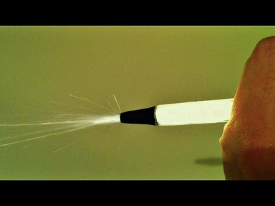

My redesign has addressed these safety concerns on two fronts. First, by enclosing the toy cap and initiating device inside the body of a pen, almost all sparks are contained. Second, simple body mechanics make it difficult and unnatural to click a ballpoint pen while pointing it at your face.
I decided to modernize the design by housing it in the ubiquitous Bic Clic Stic, often available for free as a disposable advertising medium. I give you the improved, safe "exploding pen".

Load a cap into the cap retainer, place it inside the pen body, and slide the initiator into place. Test fire, and adjust the interior collar depth if necessary. Apply judgement in use of this pen - not recommended for use on or around those with heart conditions, advanced age, or certain categories of PTSD.
The design of the cap retainer can be endlessly modified based on the materials you have available - the final picture is of some of the past designs that I have experimented with. My design goal was to create a mechanism that does not significantly change the weight or shift the balance of the pen, and also safely allowing the expanding gasses to vent out of the tip of the pen, thereby containing most of the sparks and avoiding excessive fouling to the striker mechanism.
