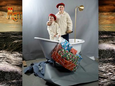

The night before the shoot, we wheeled the tub into my tiny little studio to figure out the lighting and run a few tests. After repositioning the tub and figuring out what they were going to be doing, we called it a night and vowed to start early the next morning.

Shoot day! Shoot, shoot and shoot some more... but try not to exhaust their patiences (or mine)!

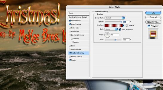

Step 18: Add Some Text
I used Burton's Revenge to continue the retro look.
Add a little layer style to it to make it as stylized as the rest of the image.
