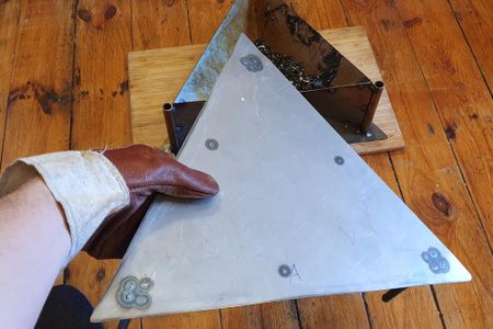

Step 1: Build the Mould
You can just have it built by a professional metalworker with the provided plans in the brochure.
But if you do it yourself mind the following tips:
- For aligning the pieces use the 3D printable jig and a magnetic welding square.
- Simple steel sheets 0.5 or 1 mm thickness will work. Cut them slightly too large with an angle grinder and sand them to size on a belt sander.
- Print out the paper templates to get the angles right. Weld it all together.

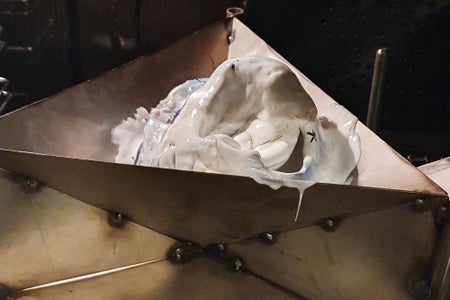

Clean everything: the material you want to melt and the mould. Vegetable oil can be used as a release agent. Grease the inside of both half of the mould with it. Break down the plastic objects in to smaller pieces to put them in the mould.
Step 5: Melt
Heat your kitchen oven to approx. 240 °C for PET, PE, PC, ABS, PS and to approx. 210 °C for PLA, PP. Temperatures can be altered but don’t exceed 250 °C to avoid dangerous fumes. Open the window and put the negative part of the mould, filled with plastic, in the oven.
Step 6: Press
When the plastic is molten evenly, bring the mould to a well ventilated area and press in the positive part of the mould by hand. Kneeing on it with all your weight helps. After cooling down for 15 minutes release the part from the mould and start again.

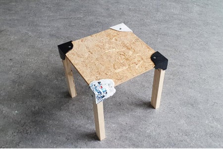

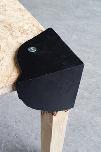

Step 7: Final Thoughts
The corner brackets shown here are just a product example. With more advanced moulds, all kinds of shapes can be pressed. These corner brackets could be used to assemble a bench, a table or a shelf using only construction wood, plywood, nuts and bolts.
