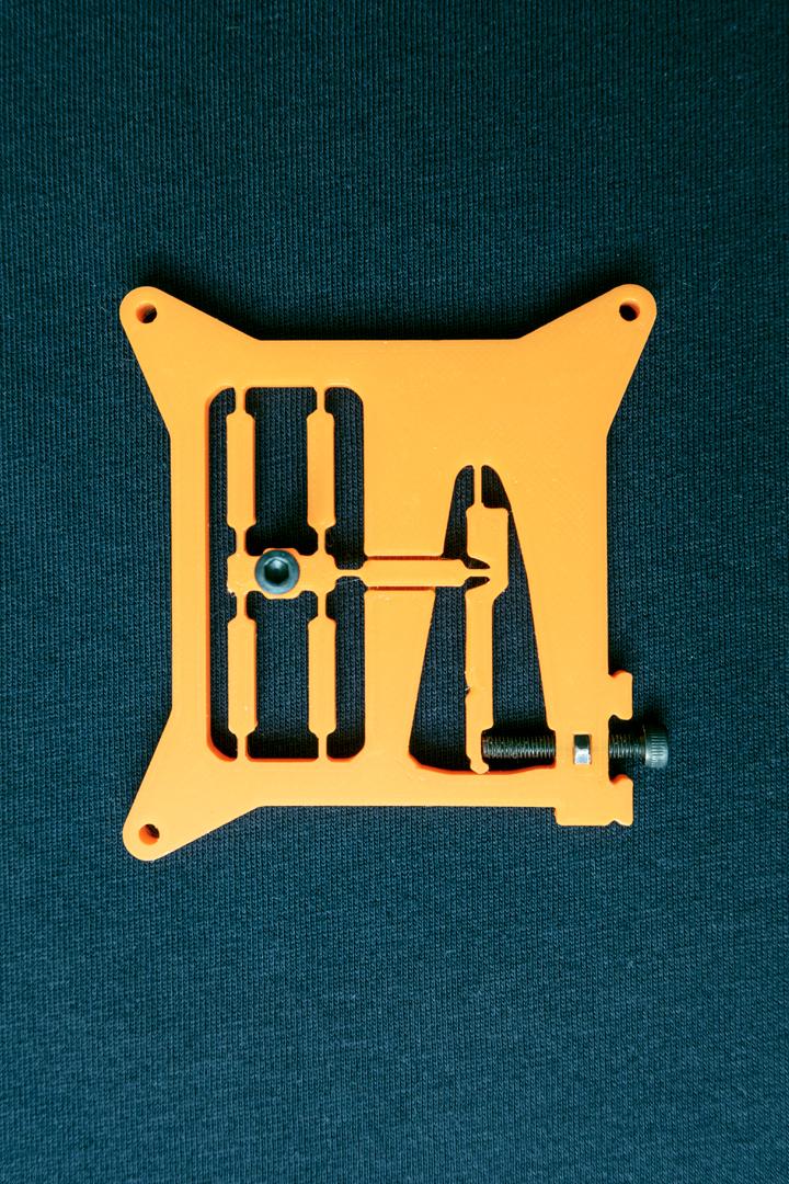

Now that you (hopefully) trust that the hinge will not fail, we’ll use it in a more useful project, a mechanical accuracy amplifier. By pushing on the input lever, you can control the position of the output in a very accurate manner.
Let’s break it down into its main components; you might see them in other compliant mechanisms!
The output shuttle is held in place by 4 long elements. This configuration makes it very easy for the shuttle to move laterally, but it prevents rotations and vertical translations. For small movements, this behaves as a linear guide.
The push rod connects the input lever to the output shuttle. When either moves, the rod will translate and rotate a bit. The longer the rod, the smaller the rotation, so by carefully sizing the rod we can neglect the rotation altogether.
The input motion is de-amplified by a lever; as we move the end of the lever, the rod is pushed laterally by a fraction of the input motion. This allows us to increase the precision of our movements!

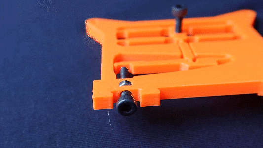

Step 3: Print in Place!
Another great benefit of compliant mechanisms is that they require no assembly. In this case, we can have the 3D printer do all the work, just print it and you are done!
