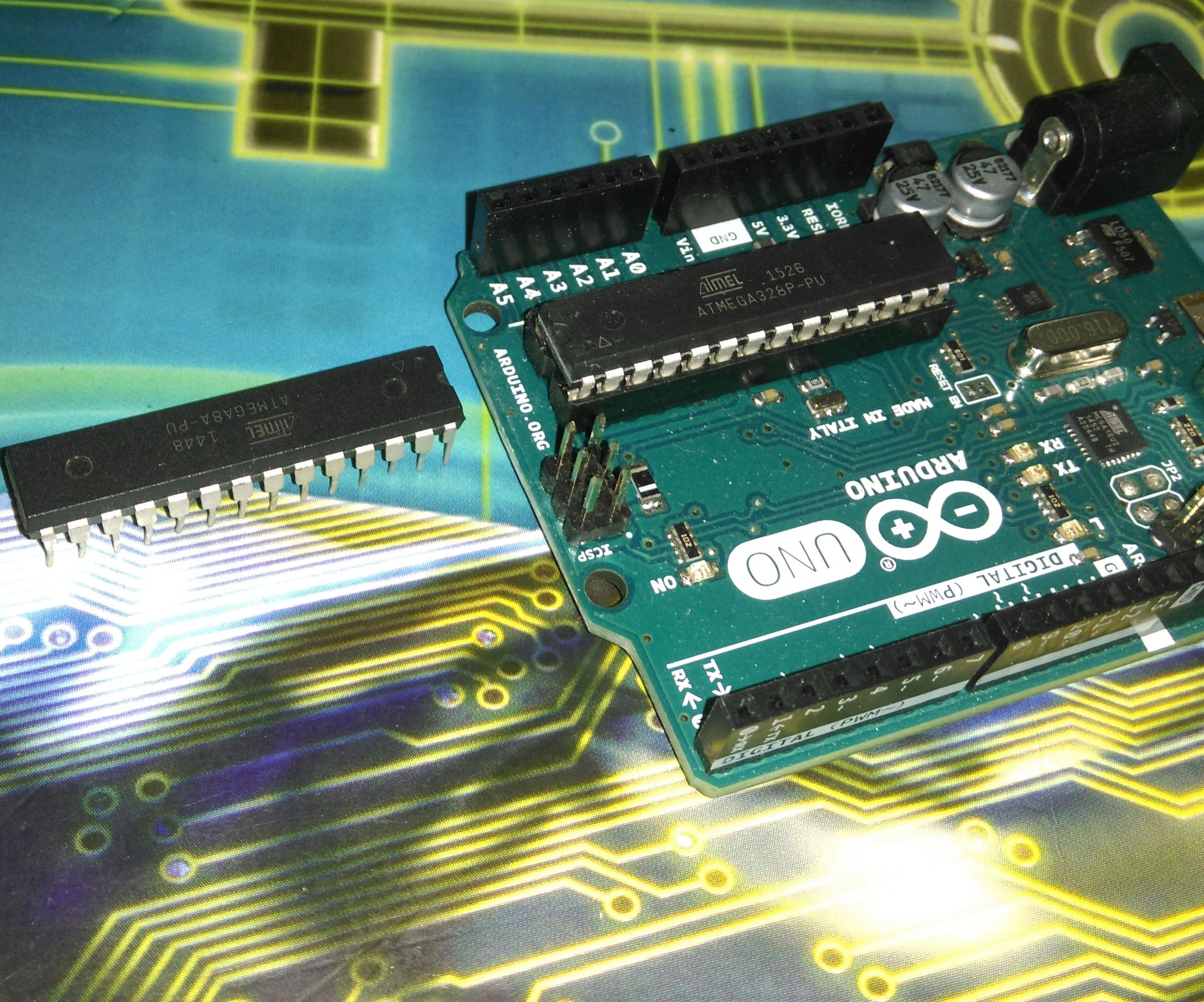

I've used both SMD parts & DIP parts to build the circuit.You can build your own PCB but i assembled the circuit in prototype board as i didn't have much time to design PCB(As this was supposed to be a weekend project)
The heart of the circuit is U1 i.e Atmega328p in DIP package.As we have to run the circuit using battery,we can't just feed power directly to the power hungry parts like the OLED display & LM393 Op Amp etc & also,can't run the circuit indefinitely!
So far,what i've done here is that the Arduino gets the power directly from the battery & goes into sleep mode.Also,it supplies power to the power hungry parts only whenever necessary to save the battery.This is achieved by the Two MOSFETS Q2 & Q1 & the biasing resistors R2,R7 & R8(These are the only SMD parts in the circuit)! The Arduino stays in the sleep mode & whenever the user press the SW2 (which is tied to Interrupt pin),it wakes from Sleep & Turns Q2 via Q1.The Comparator(U$1G1) & OLED Display then gets the power & initiated.Next,the Arduino generates a pulse via PD7(Digital Pin 7).The connected Inductor on the INDUCTOR_IN pins in accordance with the known capacitor C6 forms the resonance as we discussed before & the comparator gives a corresponding digital output which is connected to Arduino's pin PB0(Digital Pin 8).(I will explain in the code section,why i took the digital pulse on this particular pin!)
After getting the digital pulse,the Arduino measures the frequency & calculates the unknown Inductor value based on the frequency & Capacitor value as per our previous formula & displays it via the OLED display.Also,in addition,the Arduino measures the Battery voltage via the Resistor divider R3 & R4 & shows it on the OLED.After all this is done,the arduino remains on for 60s & again go to sleep & cuts off the power to the OLED & Comparator & resistor divider part by turning off Q2.In between this 60s timeout,if we measure measure again,the time gets reset & the circuit again wait for 60s to sleep & so on....
I've Used a 128x32 OLED Display for my Seup in I2C mode.Notice,there are 4 OLED PINS for the display i.e OLED_VCC,OLED_GND,OLED_SDA_PIN,OLED_SCL_PIN.
Also,if you wish to program the Arduino later,you can easily do it using a FTDI breakout board.As our Atmega328p is having the Arduino bootloader installed,it handles the job to self program without the need of any external programmer.Just connect the DTR,GND,RX & TX pins of the FTDI breakout board to the circuit's FTDI_DTR,FTDI_GND,FTDI_RX & FTDI_TX pins.You can connect them to a 4 pin header if you wish for a neat look.Note that the FTDI_DTR pin is connected to a 0.1uF capacitor which is used to auto-reset the Arduino from the Arduino IDE to put the bootloader into action.

U1: Atmega328p with Arduino Bootloader(Or you can burn the program on an UNO & remove the Atmega328p from there)
