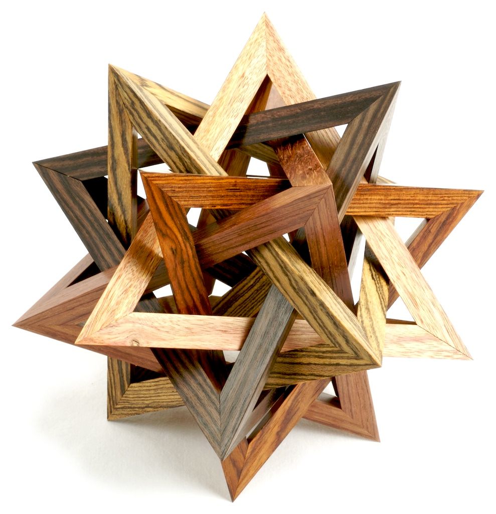

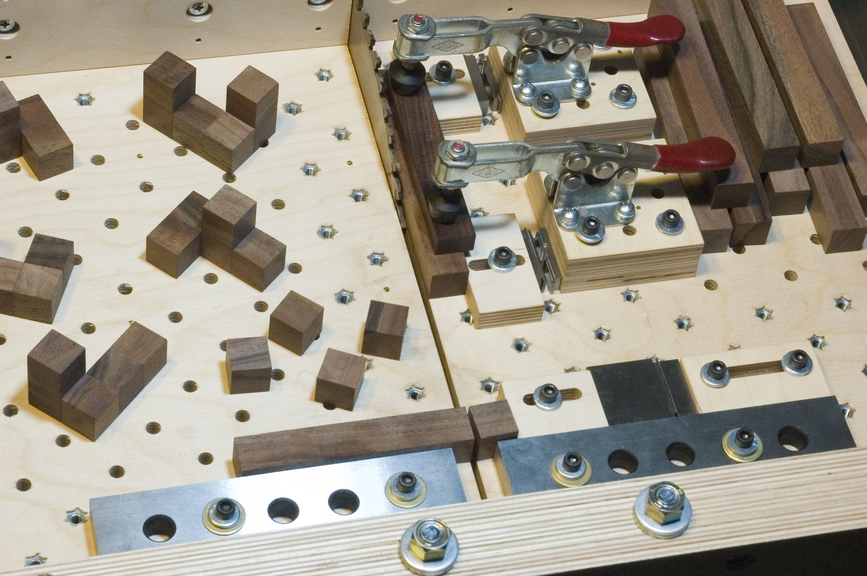

One of the projects that I'm working on at Pier 9 involves the production of a puzzle which has a wooden piece as shown in the first image for this step. I have designed this wooden puzzle piece to be made from 16 individual components which I plan to glue together: one core piece and 15 wooden strips which are each 1/8" thick, and have numerous complicated notches in them. I plan to use this 2-sided fixture to hold the 15 wooden strips all at once so that I can cut all of the notches in just one setup. I plan to use the DMS 5-axis router at Pier 9 for this job. My plan is to setup a Lang receiver plate on the DMS which I can load this fixture onto, and half-way through the program I will flip the fixture over to machine the notches on the back side. This is why I have installed the Lang 96mm Quick-Point system on both sides of the fixture.
