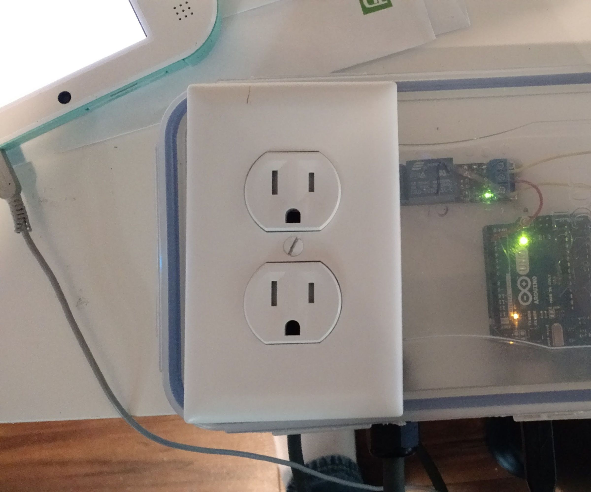

Step 1: Wiring
I actually already built this before creating this Instructable so I'm not going to do a comprehensive break down of how to create the box and If I had to make it again id use a to building code metal box since the chance of a fire is high.
In this particular instance the sensor is connected to A0 and 5v however it could be different depending on sensor
I used my Dremel to cut out the rectangle for the 120v plug and have learned to warm the plastic to soften it to prevent cracking (use a blow dryer) i also drill holes for heat to escape.
I prefer to solder and shrink wrap whenever possible
