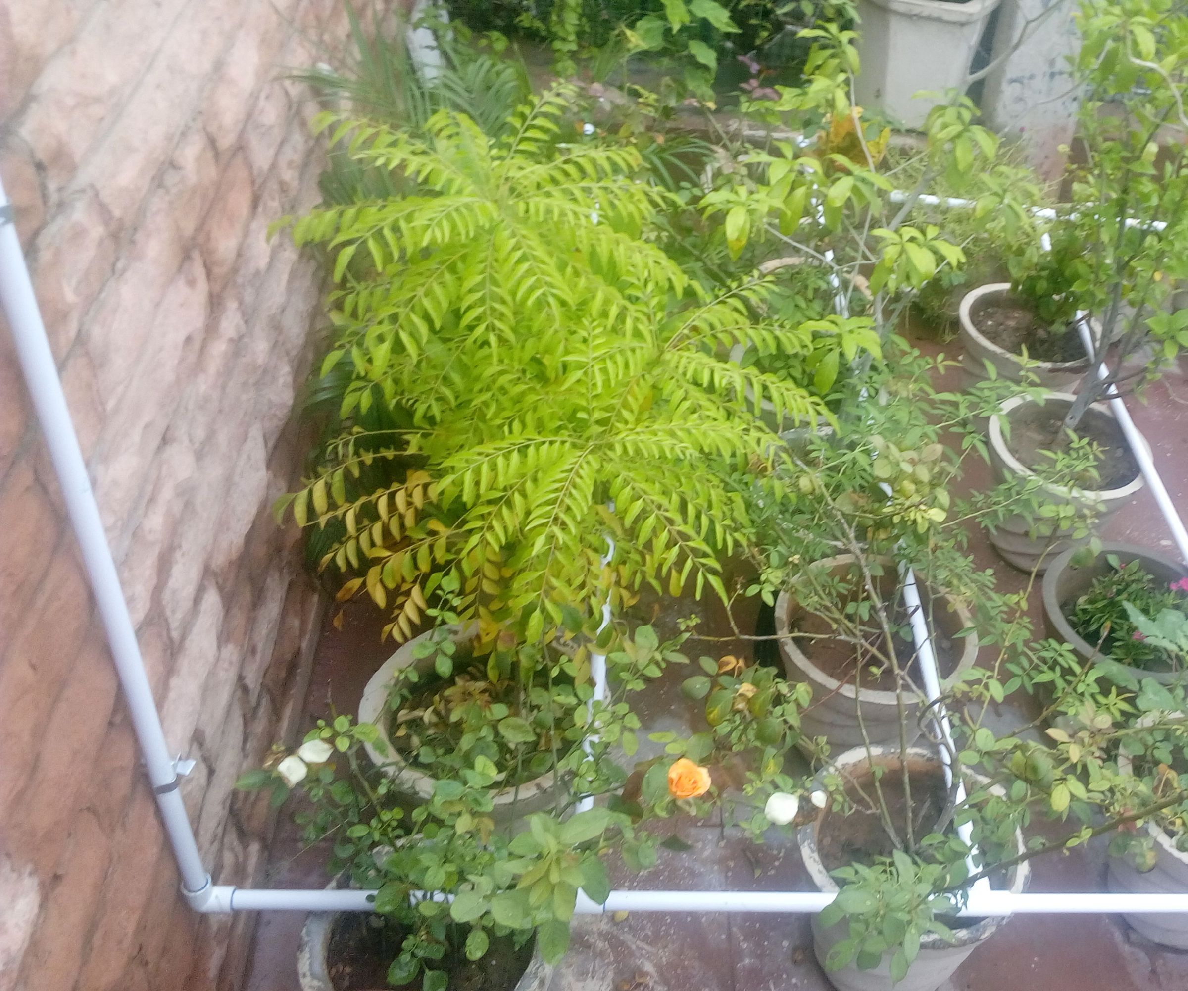

this project is used to control the level of the water in a tank.it is also used to determine the moisture in a soil and control the speed of drip irrigation system in a tank.it is also used to determine the temperature and humidity of the surrounding air.all these parameters display on LCD.when the water level is little then the pump is on and buzzer is on to indicate the water is little in a tank

place the drip irrigation system in a plastic jar
Step 6:
place the pump in bucket to supply the water and supply in a plastic jar
Step 7:
finally start the precision farming and observe that how it is precised for the agricuture
