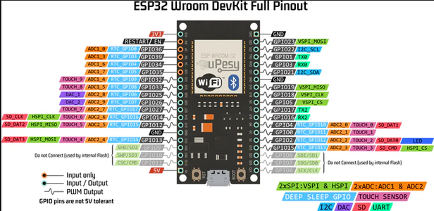

Step 7: ESP32 Pinout
Note : Refer to this diagram while making the connections for EPS32

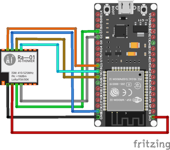

Step 9: ESP32 - LoRa Module Interfacing (SENDER)
  1. This shows the electronics setup for the interfacing between the Lo-Ra sender with the ESP32.
  2. The connections are to be made as shown below to ensure smooth functioning of the connected circuit.
Connections :
ESP32 --------------------------- Lo-Ra
GND ------------------------- GND
3.3V -------------------------- VCC
GPIO5 -------------------------- NSS
GPIO23 -------------------------- MOSI
GPIO19 -------------------------- MISO
GPIO18 -------------------------- SCK
GPIO14 -------------------------- RST
GPIO2 -------------------------- DIO0

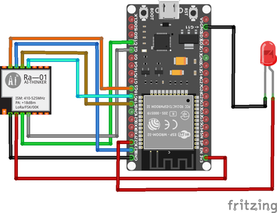

Step 11: DHT11 - Temparature Sensor Interfacing
  1. The above shows the connection diagram for interfacing DHT11 temparature sensor to interface with the ESP32 sender circuitry.
Connections :
ESP32 ----------------------- DHT11
5V ------------------------- 5V
GPIO22 ------------------------- Signal

Step 14: LED Interfacing
  1. The above shows the connection diagram for interfacing LED to interface with the ESP32 sender circuitry and to act as a status indication LED.
Connections :
ESP32 ----------------------- LED
GPIO22 ------------------------- LED (+)

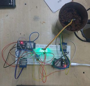

Step 15: Powering Up the Circuit
  1. After the correct setup of the overall electronics circuitry we are ready to finally power up the whole system.
  2. You can use a 5V battery to power each of the two category components i.e, at the farm site and the home site.
  3. I have used a 5V adapter of B-Type Cable to power both the ESP's through their USB ports itself.
Our Electronics setup is ready now.....
