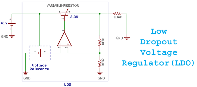

Step 1: Circuit Design
  1. Refer to the PBU605 datasheet for the recommended application circuit and configuration.
  2. Design the input and output capacitor networks to stabilize the voltage and minimize ripple. Typical values might range from 10µF to 100µF, depending on the datasheet recommendations.
  3. If the output voltage is adjustable, use appropriate resistors to set the desired output voltage according to the formula provided in the datasheet.
