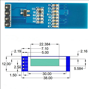

In this project, we design a portable, precise, and self-contained weighing system using an HX711 load cell, Arduino Nano, OLED display, DS18B20 temperature sensor, battery voltage amplifier, on/off switch, calibration, and tare buttons.

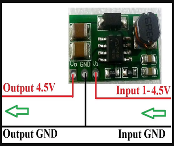

✅ Portable & Wireless Use: Standalone operation with battery and voltage amplifier.

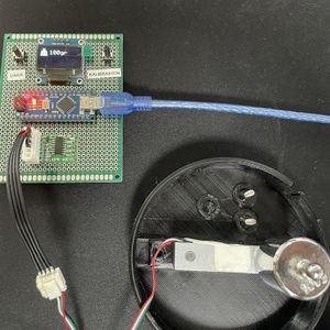

I first started the project by creating a prototype with the HX711 load cell, Arduino Nano, OLED display, DS18B20 temperature sensor, calibration and tare buttons, on/off switch, and battery + voltage amplifier circuit. At the first stage, I tested the operation of the system by connecting the components together. However, the clutter of cables and external components reduced the portability and ease of use of the device.

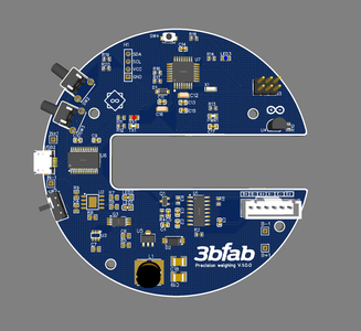

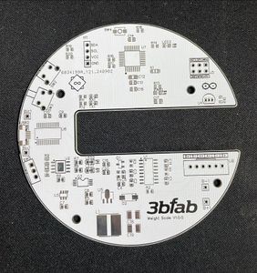

To solve this problem, I decided to design a custom PCB that packs all the components on a single board. I drew the circuit using EasyEDA and had it fabricated on the JLCPCB. The design has been optimized to fit snugly into the 3D printed chassis, resulting in a more compact and uncluttered structure.
The result is a precision weighing system that is sleeker, more durable and easy to use. Now it's time to test all the components by soldering them to the PCB and complete the software optimizations!
