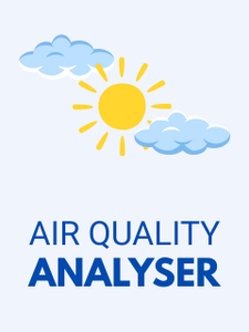

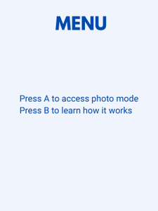

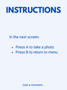

Screen and User Interface
The display is surprisingly capable, yet the official unihiker_k10 library has limitations - you can set text color and background color, but you cannot:
  1. Change font type or size
  2. Adjust line spacing or letter spacing
  3. Apply gradients or advanced graphic effects
Despite this, I designed a clear and interactive interface:
  1. When the user powers on the K10, a logo screen appears, followed by the main menu.
  2. The menu instructs the user: press A or B to navigate.
  3. Press B → opens an info screen with a short explanation of the system
  4. Press B again → returns to the menu
  5. Press A → enters photo mode
  6. In photo mode, a short message explains how to take a picture.
  7. The camera opens, and the user presses:
  8. A → takes a photo
  9. B → returns to the menu
  10. After taking a picture, the AI analyzes it and displays the predicted AQI classification on the screen.
Because of the library limitations, I implemented a workaround for a more visually appealing UI (user interface):
  1. I designed all interface screens in Canva
  2. Saved them as images on the micro SD card
  3. The program loads the correct image as the background whenever the user navigates to a screen
You can see the screens of the system in the images above.
