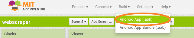

I have attached apk file just in case you want to give it a try. However I recommend that you download the source code (.aia file) and import it to App Inventor to discover it yourself.

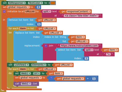

Step 5: Processing the Contest Main Page
In the same manner we extract the contest entries URLs and pack them into URLList. Afterwards we perform GET request for each item of the list.
