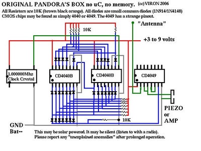

The Pandora's Box instructable now includes info about a Singing Calculator Number,
which is from the sequential digits of the number that is the subject of this instructable,
and a planned simple device for feeding that number into a speaker to get music.
NO PROGRAMMABLE CHIP IS NEEDED.
This sounds different than my other Pandora's Box which needs a programmable chip,
but when the schematic is done for this, so will be the uncomputerized original P Box.

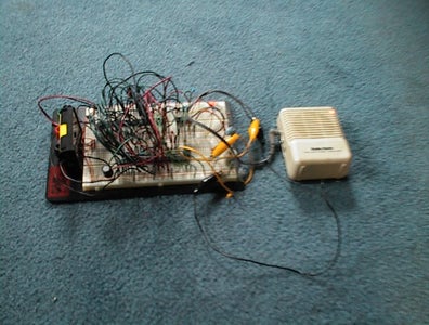

Step 1: More Info, What Is Needed?

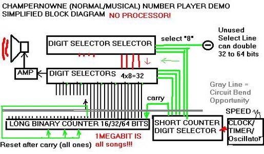

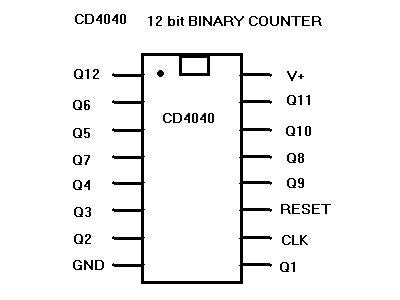

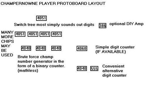

I have reduced and minimalized this so that a small handful of
nice cheap 4040 and 4051 chips may be all you need.
(and battery, wire, solder, iron, speaker, breadboard, etc.)
HEADACHE WARNING: MATH AHEAD (Only "math heads" need to know.)
At this point the simplest musical calculator using "normal numbers" will use a brute force
method that pulls digits out of thin air using a binary counter, which is not considered a
computer, although it calculates all possible combinations starting with zero. Normal numbers
contain all other numbers, and the ones which can be made by counting contain them all
in order. And this is interesting because files and numbers are both the same thing, strings
of bits. This is well demonstrated in the simplest way I can imagine, in that number which
will play as the calculator song.

The original Pandora's Box instructable had constraints, so that it's output would
never sound like static. This one does not have noise-avoiding constraints, except
that as another demo it is not designed to go so far into the calculation that we
will lose the sense of the pattern in the sound which is the process of counting.

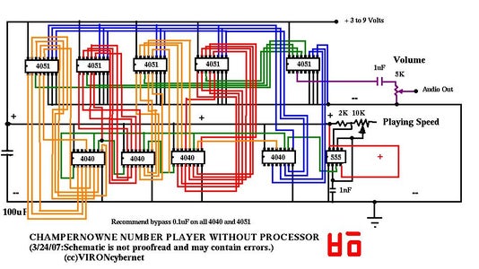

I'm expecting the finished circuit to consist of a few logic chips, (no uC or uP)
so you'll need a soldering iron, a speaker, and chips which I haven't chosen yet.

I apologize for the premature publication but I feel I must announce
this project before the RIAA (possibly) very shortly tries to own it. OK, OK, now!
Oh what a mess.
Well , the main reason it's a mess is because of the way they made the chips.
It's going to be hard to draw the schematic, but meanwhile I'll be very simple about it.
Now why would you want to build this?
You can hear what it sounds like with the mp3 on the previous step.
It doesn't need to be messy, and it's very bendable.
In fact, if I break the rules and use a programmable chip, and remove some of these,
we can play the "calcul8" song and as much other music as can fit on an
i-Pod, and it MIGHT even sound as good or better than mp3's. I won't claim that
anymore until I demo something like that.
Oh what a mess.

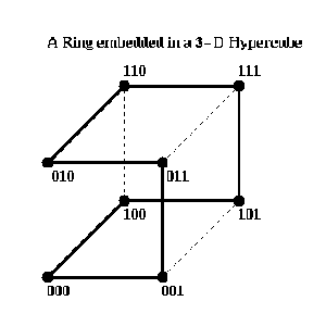

Step 4: SIMPLE OUTLINE OF THE CIRCUIT
This basically is supposed to show how the circuit simply counts
and the rest of it just reads out the digits of each number into an amplifier,
before the next number is counted. And what's under the mess of wires on my board.
Each number is a sound, just like Calcul8.txt (pocket.wav) is a number and also a song!
Step 5: Helpful Chip Pinouts
Here I simplified the pinouts of the chips so when anyone makes this
(including myself before I made it) they can have something to look
at and not get confused by the mixed-up pinouts.
These chips can run on from 3 to 9 volts, not only 5 volts.
It's recommended that each one has a 0.1 uF capacitor across the power
(even if I don't include it in the schematic).
I'm having minor trouble with the schematic(s) at the moment, but no worries.
I might just do it by hand.

You might be able to build it now without my schematic,
but if not, don't worry, I'm drawing it now, and working
on my video demo. This one will be made on the old junk,
the cool analogs, because I know Movie Maker is just a
silly pain in the butt. I don't buy stuff I MAKE it!
One thing remarkable about this current "1971-tech" demo
that this instructable is going to show you how to Make is
that it seems to generate ALL THE BEATS, if not all the tunes!
Getting the tunes involves some weird math, but not too weird,
because "zero point one two three infinity" is simple arithmetic
that just requires a calculator with a million digits.
It would take billions and billions of years to hear every sound,
but any one can be downloaded from "the multiplication table"
faster than the speed of light!
THIS IS MY IP. NO ONE EVER DID THIS THIS WAY BEFORE.
As I said before in P-Box #1 and again, IT'S "FREE"!
What am I showing you? In Kindergarten terms, you just learned
to count, and therein is the sum of all human knowledge!
Sorry for the delay on the full schematic and video; I hope it's short.

Step 7: Breadboard Schematic
For a few hours this looked ridiculous without the schematic.
It's a rough one, still being checked at this time.
Check back every once in a while for updates.

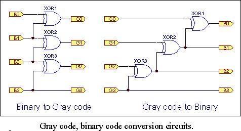

Teaser: Gray Code enumeration: It moves along the edge of a cube of
dimensions equal in number to the number of bits. To bend this into
gray code without programming, you would need 32 XOR gates.
Perhaps you would prefer the PIC code, as in the original P-Box...
This has too many wires!
QUICK BENDS:
If you build this and get tired of how it sounds, I recommend mixing up the
"blue" wires on the 4040 next to the 555.
The 4051 wire order isn't as noticeably significant.
Removing one or two "green" wires from the last 4051 maybe interesting,
which I did backwards by building the circuit with power on it.
And of course, turn the playing speed knob.
The "green" wire on the left 4040 pin 1 is a reset trigger that "never" resets.
So move that reset wire to other pins and expect major changes in the sound.
I'm concerned about the 555 going too slow, but IF that happens
(making only low pitched sounds at all speeds)
try changing the 555's capacitor from 1nF (0.001uF) to 100pF.
The 555 was not tested in the circuit, I used a 4060 instead.
It will work though. Like in my hypnosis glasses instructable.
One advantage of this no-brain "mess" circuit is the convenient bending possibilities.

This is the schematic drawn from the breadboard on Step 2.
I mentioned before it's limited to 32 bits, unless you add more chips.
Twice as many chips gives 64 bits.
Eight times as many gives 256 bits. If you got the chips, the sky's the limit.

P-Box #3 involves a number that excludes impossible sounds and requires less
"imaginary memory". Notice the imaginary memory in the schematic in step 7,
whereby gigabytes are pulled out of nothing. There is an intangible ROM (imagine it
as an invisible disc made of nothing) being played. The sound format is slightly
foreign to PC's, after all, if a text number can sing (calcul8.txt or pocket.wav),
but your OS doesn't recognize it as playable in spite of it's simplicity, well, this
is what challenges me. Calcul8.txt and Pocket.wav play better and equally well
on raw electronics or logic which is not programmed to reject ANY data!

Step 10: ORIGINAL PANDORA'S BOX CIRCUIT
This one has been struck twice by anomalies, and now is in an unbelievable condition.
One difference: I used a 1.842000 crystal.
UPDATE: ***It has just been found that there is an error in this schematic,
and pins 9 and 10 (upper right pair) are reverse connected on both 4040's. ***

Step 12: Gray Code, Another Musical Number Counting Method
Gray code is one of many alternate methods of counting in binary,
usually the one which walks around unit cubes and hypercubes of
any number of dimensions, these dimensions being the powers of
the digits in a musical number.
The most common gray code is translated back and forth by the
integer formula G = N XOR N/2 (N = G XOR G/2).
Working with 0.123 type numbers in gray code is not convenient,
and the number 0.123 (123...) converted to gray code is not very
musical sounding to me. But it does seem to be useful for grouping
musical numbers together in an order. Recent experimental calculations
show that skipping numbers and converting them to gray code will
generate all the musical numbers, at least short ones. For example,
counting to 16 using even numbers and converting those even numbers
to gray code will generate all 6 4-bit "Musical Numbers".
Number,Even?,Gray,Musical?
0000,yes,0000,no
0001,no,0001,no
0010,yes,0011,YES
0011,no,0010,no
0100,yes,0110,YES
0101,no,0111,no
0110,yes,0101,YES
0111,no,0100,no
1000,yes,1100,YES
1001,no,1101,no
1010,yes,1111,no
1011,no,1110,no
1100,yes,1010,YES
1101,no,1011,no
1110,yes,1001,YES
1111,no,1000,no
A "Secret" loosed: Musical numbers in Binary are permutations of a square wave,
(combinations of an equal amount zeroes and ones)
where for every zero there is a corresponding one. (Average bit = 0.5)
The stream equivalent of Binary Musical Numbers include Delta and PWM.
Gray codes may be a good method for locating Musical Numbers faster,
but they do not reject Noise and Silent Numbers. Images included on this
instructable page:
Gray code converter for Bending the champ counter,
The gray code "cube walk",
The tesseract hypercube (all dimensional hypercubes can be walked in gray code),
(Look for the 8 regular cubes which are the sides of the tesseract!)
It appears that hypercubes can be rotated so that all the Musical Numbers
"Appear to align in a straight line between the "poles" between 0 and "all ones".
Summary of this lesson: No matter how "big" a number is,
you can always find a way to calculate or count to it.
The Gray code example is given for small numbers,
but a million digits or dimensions are no big deal (or won't be in the near future!).
