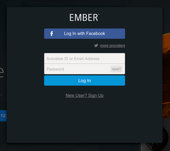

First, you'll need log in. If you've already set up an Autodesk account, you can login using these credentials. If you don’t have an Autodesk account, you can either create one, or login with credentials from Google, Facebook, etc.
Once you've logged in, you'll have access to all the features of Ember's web portal.
