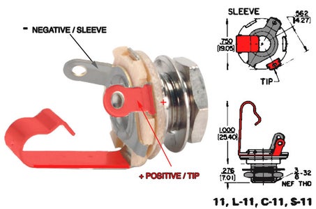

You need to identify the "tip" and the "shield" in the female jack:
You will see a longer terminal and one or two short terminals (the image shows a plug with two short terminals). Take a multimeter. First, just to demonstrate your use of the multimeter, make sure that the longer terminal and the sleeve are internally connected (by placing the multimeter leads to them and noting there is no resistance).
Likewise, one of the short terminals will also be connected to the sleeve (look at the grey colored short terminal in the image).
In the simple case (like this) where there are only two short terminals, the two wires (at one end of your cable) will be each soldered to one of the wires.

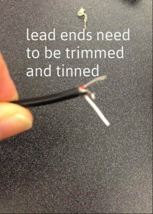

Make sure you size, trim and pre-tin your lead.

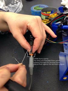

Take the mounted female jack. If you have a male mono jack, connect it to the female jack making it easier to hold (see images).
Thread the pre-tinned end of the wire from the center of the jack outward, through the terminal holes. Try to bend the wire so its ends lay flush with the terminals, and the insulated parts don't block the male plug (when it's plugged into the female jack).
Solder away!
Visually inspect and test your jack. To test, you can both plug in a mono jack and use a multimeter.
