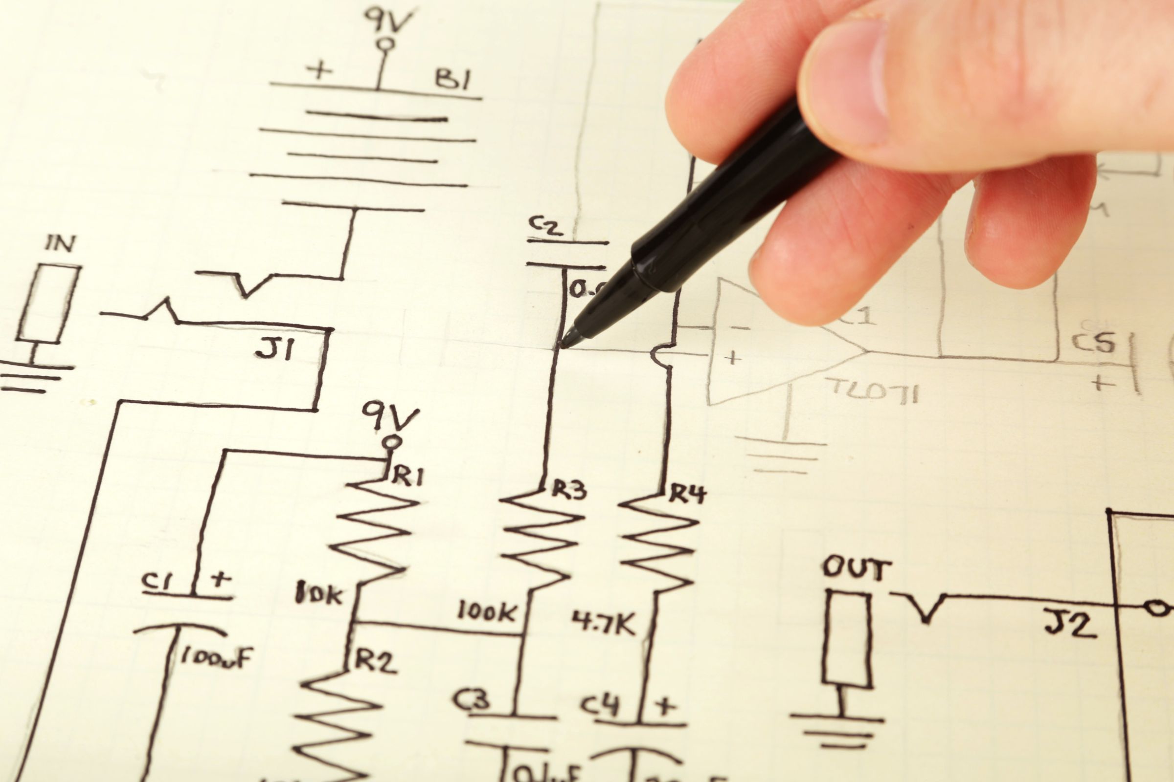

Step 1: Draw a Schematic
I'm going on the working assumption that if you want to make a PCB you already know what a schematic is and how to draw one. If you don't, I highly recommend first completing my basic Electronics Class.
To begin, draw out a schematic of your circuit on a piece of paper, using the breadboard as your guide. Even if your circuit is copied from a different one, draw it out again. Perhaps you changed a connection or a value of a component and forgot about it, or perhaps the original circuit was drawn incorrectly. Either way, you want to make sure you have drawn the definitive schematic of the circuit you are making, drawn in a manner that quickly makes sense to you. This schematic will later serve as your blueprint for making connections in the design software.
It is helpful to use a pencil in case you draw something incorrectly and need to quickly make a change. For instance, I forgot to add in a DPDT switch that lives off of the breadboard and is used to toggle the audio signal routing.
When I'm done and sure the schematic is correct, I like to trace the whole thing in marker to finalize it. Pencil tends to fade or get rubbed away over time.
Once it is traced, I then like to erase the remaining pencil marks to make it nice and pretty-looking.

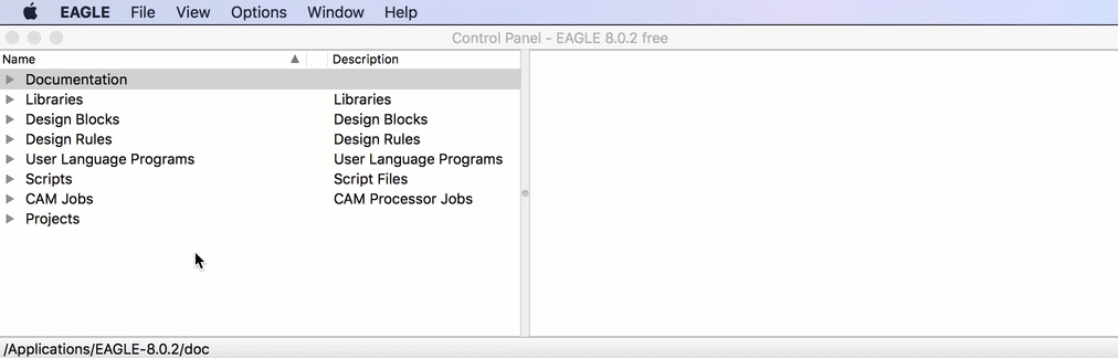

Once we have our schematic and BOM sorted out, the next order of business is to setup Eagle CAD.
Launch the software. First it will ask you to login using your Autodesk ID and then it will launch the Control Panel.

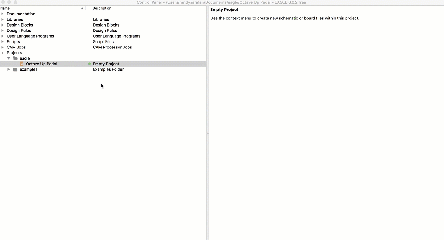

Expand the Projects folder list on the left-hand menu, and then select the Eagle folder.
Next, either select (File > New > Project) from the top drop-down menu or right-click on the folder and select "new project" to create a new Eagle project. Name the project after the circuit you are making, and hit enter on the keyboard.
Our digital schematic and PCB design will live within this project. However, before we can access those, we need to create them.
To begin we will create just the schematic. The board file will be created later, once we have the schematic nailed down.
To create the schematic, select the project you have just created and then select (File > New > Schematic) from the top drown-down menu. Alternately, you can right-click on the project and select the same. A new schematic window should load.
Save this window by selecting (File > Save) or pressing command+S to load the save menu. Name the schematic whatever you want (like "Flying Monkey Zebra"), but I find it helpful to call is something intuitive like "[name of project] schematic"

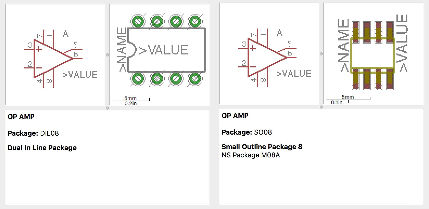

To begin, let's try something easy. Let's search for "op amp" and find the TL071 op amp that we are using in the schematic.
Notice that the part has a drop down arrow. What this means is that the part has multiple packages (surface mount and through-hole) and also has different footprints to choose from. You need to select the footprint for the board you will be using. If you select the surface mount footprint for a through-hole part, you will not be able to assemble your board correctly.
You can tell the difference between a surface mount and through hole part because surface mount will have an abbreviation which starts with "S" and through-hole will have an abbreviation which starts with "D." Aside from the obvious naming conventions, surface mount parts will have pads without holes in the center because the pins are mounted to the surface, and through hole parts have pads with holes in the center because the pins are passed through. It's actually fairly intuitive.

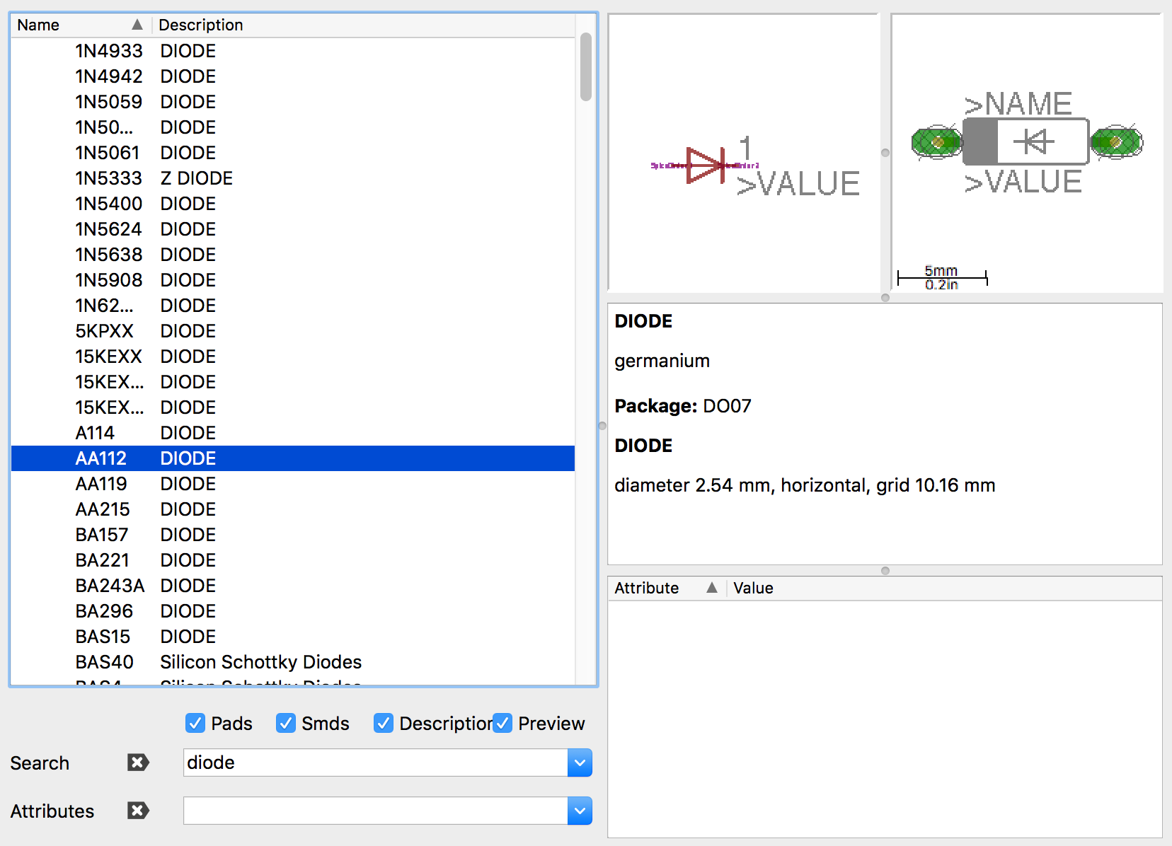

For instance, if we were to look up a 10K resistor we will find that it has an "axial" package. This lets us know it is through-hole, but it still does not tell us the exact footprint we need since axial resistors come in a wide range of sizes. Fortunately, they also let us know the dimensions are 2.3mm x 6mm. From this information we can determine that we need a resistor package with at least 7.5mm spacing between leads (since bending the leads for through-hole mounting requires some additional width). However, to be on the conservative side, I decided go with 10mm spacing between leads.
When the software states "grid 10mm" under the part attributes for this through-hole resistor footprint, it indicates that we have found a resistor package with a 10mm lead spacing and ultimately what we are looking for.

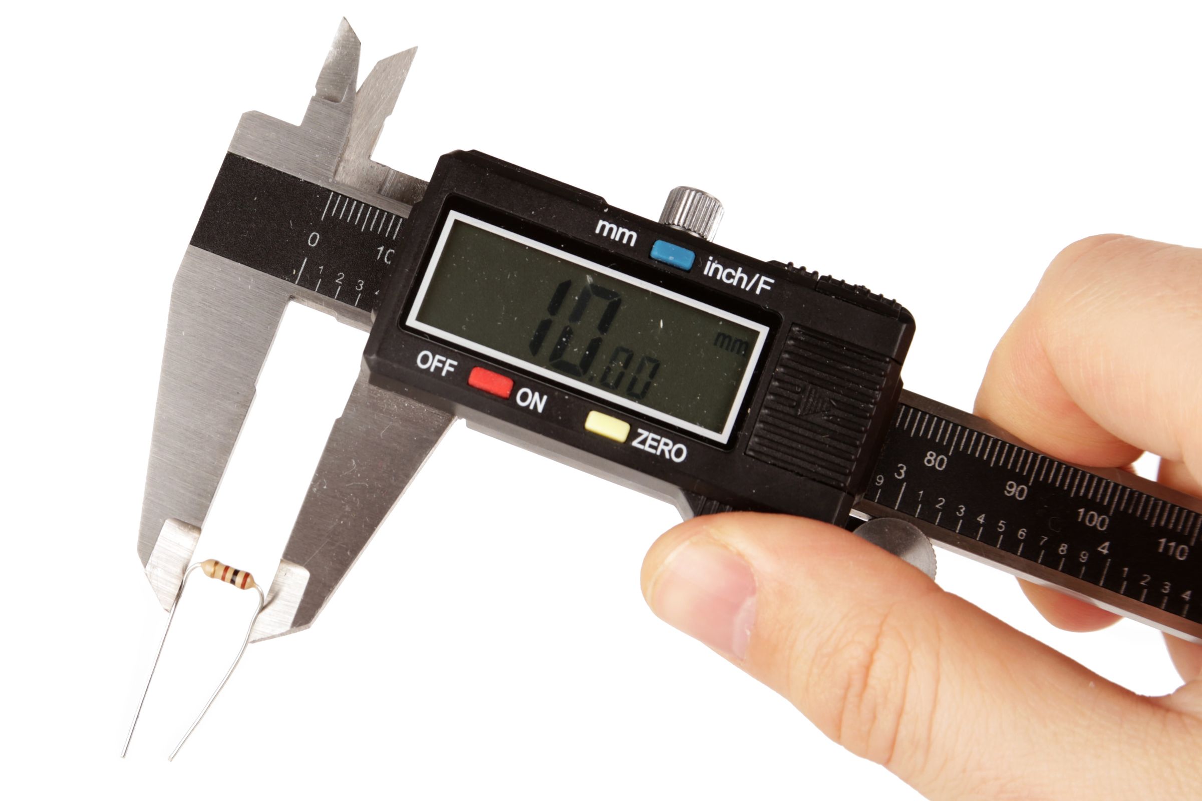

Alternately, this is also where calipers can come in handy. Instead of looking up the lead spacing, we can simply measure the lead spacing and use this measurement to figure out what part footprint to select.
Calipers can also be used to double-check that the measurements given online are correct if something seems fishy.
Sometimes you won't find exactly what you are looking for. In those instances, you can find a similar part with an identical footprint. For instance, I could not find a 1N34A germanium diode, but it has a DO-07 footprint. Instead I am going to use an AA112 germanium diode which also has a DO-07 footprint.
For our purposes, this should be good enough. It will show up on the board as a diode with the correct footprint, and for what we are currently doing, that is all that really matters. If you were going to get deep into Eagle and start running circuit simulations, this might make a difference. However, that is well beyond the scope of this class and our goals.

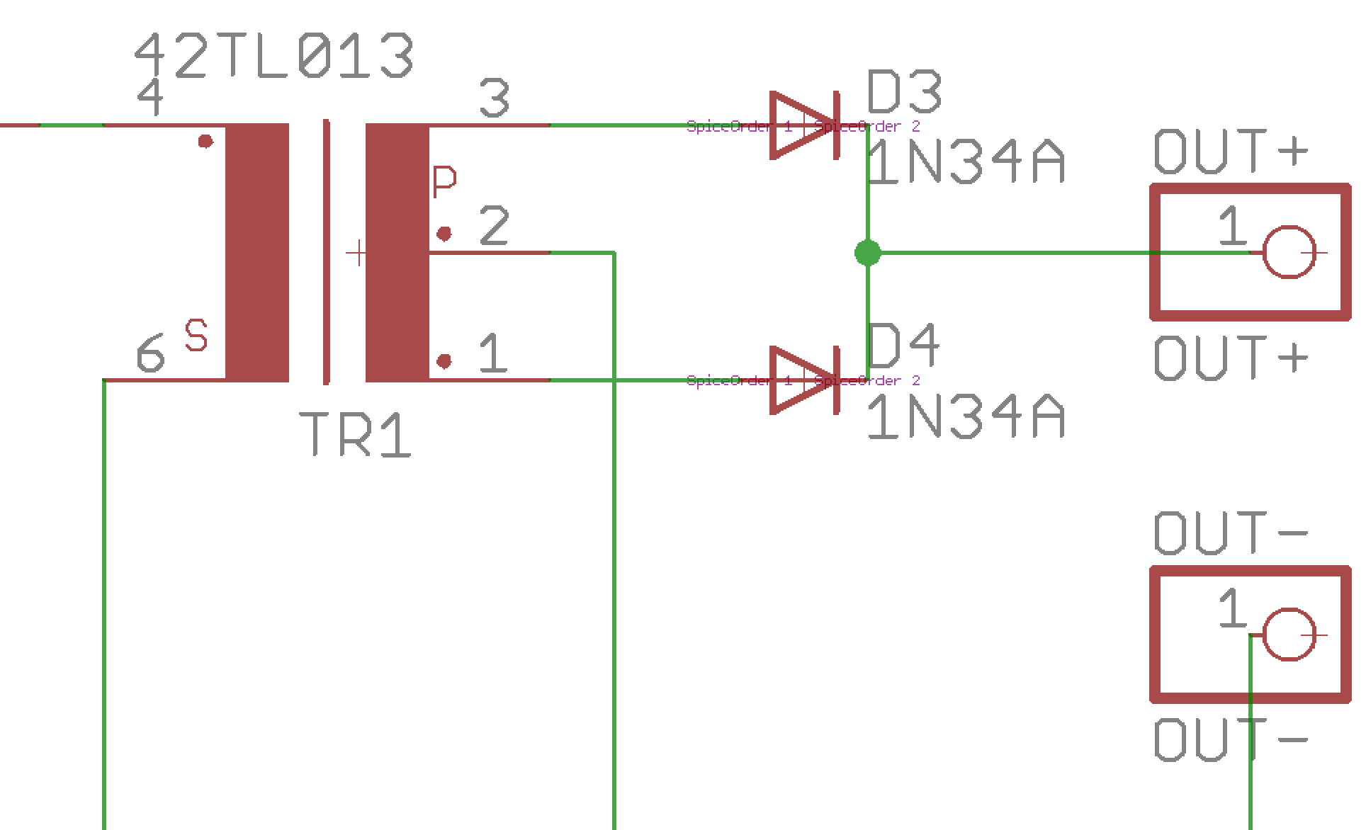

Once all of the symbols are arranged and labeled correctly, now it's time to connect them together. To do this we will use the NET tool to create connections between the symbols. All of the connections we make match our hand drawn schematic, with the exception of the components that we have determined do not mount directly to the board. In these cases, we just need to make sure the appropriate pin headers get connected to the appropriate spots.
Often connections will overlap one another without actually connecting. You can tell the difference between a connection and an overlap by the presence of a green dot. For instance, both diodes connect together with the output pin header because all three lines converge at the green dot. However, pins 1 and 2 do not connect together because there is no dot even though they intersect.
Sometimes you might make a connection which looks okay on first glance, but is not a connection at all. You can see an example of a bad connection here on pin 3. The long darker green overlapped section indicated that there isn't actually a connection there. An actual connection should look like the small green dot on pin 2.
To fix this, you need to delete the green line by selecting the Delete tool from the left-hand toolbar. This is easy to find because it looks like a little garbage can. Once the tool is selected, click on the line to delete it, and then you can go back and redraw the line with the NET tool.
When you have a lot of symbols connecting with one another, your circuit can get confusing very quickly. An easy way to tell if a connection is good is by moving the symbol you are unsure about and observing to see if the connections get dragged along with it. If they all appear to move around with the symbol, the connections are reliable.
Finally, once all of the connections are made and you have meticulously double-checked your work to make sure that it matches your hand drawn schematic, you are finally ready to make a circuit board.
