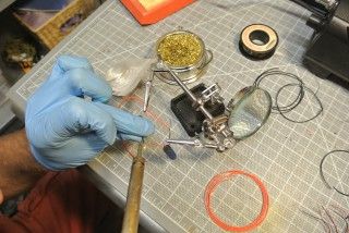

Using your wire cutters, cut your positive & negative (black & white) wire from spools, at about 2 to 2.5 inches. These wires are called your leads. Next, you will take the leads and strip them of their plastic encasing with your wire stripper. Do this to all leads and set aside for future use.
With your 9mm Encapsulated Vibe Motor, you will also need to strip the flying leads attached to the motor. To do this, you will need to take your wire strippers again, removing the plastic encasing.

In order to work safely and efficiently, we use clips to stabilize our wires while soldering our flying leads from the 9mm encased motor to our newly cut leads that we wish to bind together. After stabilizing your motor’s wires and your lead wires, you will then be ready to solder each positive and negative wires to the leads. Remember to use your clips to position your motor’s flying leads, so that they come in contact with you newly cut leads. This allows for an easy, safe, and accessible way to solder your wires together. Before picking up your soldering iron, make sure to take this step.
Step 4: Attaching Leads to Motor
After positioning your wires, take your soldering iron and make sure the tip is clean. We use coils of brass to dip the soldering iron into, cleaning oxidation and excess solder from the tip of our iron. Next, grab either one of your wire leads, your solder, and your soldering iron. You will begin by touching your solder to your soldering iron. Almost immediately, you should notice that your solder becomes a liquid like substance upon contact with the soldering iron. You will then take your soldering iron and the newly melted solder to bind your wires.
Apply your solder to your soldering iron, taking the newly melted solder to adhere one set of the wires together. Make sure you allow enough of the solder to be melted onto the wires, we want a secure connection so that we can ensure functionality in the motor. If you find that you need to apply more solder, simply take your solder and apply it yet again to your soldering iron, melting more of the solder onto your wires to reenforce our endeavor. Almost immediately after applying the solder, binding the your leads to your motor’s flying leads, you can blow on the connection to cool solder down. You will perform the steps above for each set of wires, cleaning the tip of your soldering iron in between each bind with your coil of brass. When not using your soldering iron, make sure to place the iron back in it’s holder. When finished soldering altogether, make sure to power off your soldering iron.
