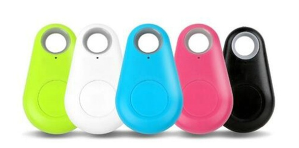

Today, we are going to talk about iTag. This is a keyring with technology similar to iBeacon, Bluetooth BLE, which serves as a presence detector. This is a wonderful example of residential automation. Let's use an ESP32 programed with Arduino IDE.
This assembly has thousands of uses: the garage door can perceive its approach and open alone, lights turn on according to the detection of its presence, among other innumerable uses. Not to mention that every resident of a house can have their own locksmith and make their own choices regarding the execution of commands in a certain environment.
I want to point out that our assembly with the ESP32 allows the Bluetooth radio to detect presence by a certain radius. This is performed through the dbm signal, which makes it possible (for example) to locate or track people within a location, and specific individual product identification, among others.
In our project, instead of connecting a relay, we light an LED that is already inside the ESP32. But in your source code, if you're automating something, you're going to have the ESP32 hook up a pin that turns the relay on.
Step 1: Demonstration
In the demonstration, we have the ESP32 with a blue LED representing an activated relay. As the key ring is close to the ESP32 (at a distance between 6 and 10 meters), it activates this pin. Both are Bluetooth BLE, meaning low power consumption.
