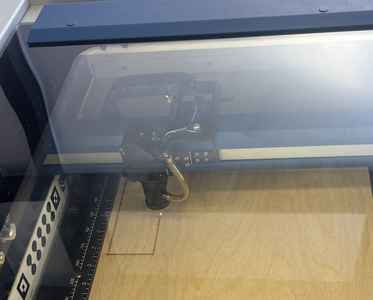

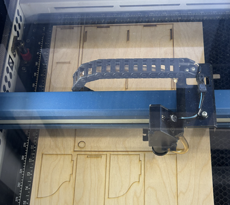

Step 3: Laser Cutting
In this step, I exported my design file from Fusion into a .dxf format and brought it into Adobe Illustrator. From there, I prepared the file for the laser cutter. This process involved some trial and error. At first, I accidentally missed a line, which required me to recut a few pieces until everything came out correctly.
Step 4: Fabrication Process
In this step, I began assembling the pieces, which I originally thought would be easy since I designed all of the joints to be the same size. However, once the pieces were cut, I realized that I had accidentally left out a few joints in my design. For some reason, I hadn’t noticed they were missing before sending the file to the laser cutter. When I tried to press-fit the joints I did have, they didn’t fit properly, so I had to sand them down until they slid together, which ended up working pretty well. For the joints that were missing, I had to use super glue, which was a little disappointing since my original goal was to have the entire piece held together only by the plywood joints.
