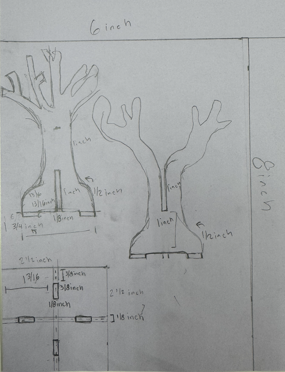

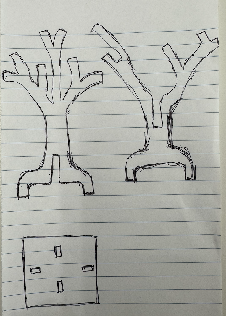

Step 1: Sketching the Concept
I began by sketching my idea, which was a press-fit tree made from three different shapes. The base consisted of four cut-out slots where the press-fit joints would hold the structure upright. The other two pieces represented tree trunks with branching forms, designed to slide into each other through an opening in the middle. I intentionally shaped the branches to function as holders for rings and jewelry, giving the piece both form and utility.
Step 2: Designing the Base in Fusion
I modeled the base in Fusion with precise measurements to ensure stability. Accuracy here was crucial so that the tree trunks could slot securely into the stand.
Step 3: Building the Tree Forms in Fusion
Next, I designed the two trunk pieces, carefully aligning dimensions so they would slide together perfectly at the center. I also ensured that the press-fit joints at the bottom of the trunks matched the base openings for a snug fit.
Step 4: Finalizing Dimensions & Preparing the File
I reviewed the design, checked that it matched the 1/8-inch plywood material thickness, and factored in adjustments for the laser cutter’s kerf (0.25 mm). These refinements ensured the joints would lock tightly without being too loose or too tight.

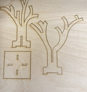

Step 5: Exporting & Laser Cutting
After exporting the file to Adobe Illustrator, I laser cut the design. One issue occurred when a line was missing on one of the branches, so the cut didn’t go all the way through. I resolved this by finishing the cut with an X-Acto knife.

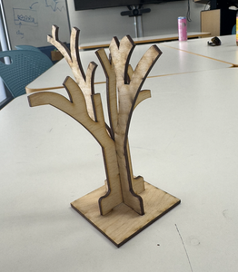

Step 6: Assembly
Finally, I pressed the pieces into place: the trunks sliding together at the center and then fitting securely into the base. The finished design successfully held its form and served its purpose as both a structural press-fit project and a functional jewelry holder.
