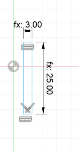

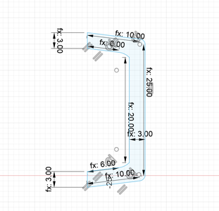

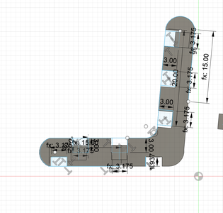

The parameters above show the final measurements that I created based on the measurements of a Smiski, following the vision I had for the chair. The chair height would be 25.00mm therefore I split the measurements between 10mm for the legs and 15mm for the height of the back. The slots in the sides, for the back panels to fit in, took the greatest amount of trial and error for this project. The first variation resulted in the slots being too small for the panels and not letting them fit through the chair. After adjusting with kerf, I found that the width of the slots should be the ply, in this case 1/8 in, + the kerf, 0.25 mm, which ended up giving a tight, sturdy fit. Based on the shorter height of the chair, I made three back panels stretching across the chair and two for the seat. The legs I designed to also stretch between the sides of the chairs and pressing into slots on the bottom of the chair. After building the 3D model out of each component, I created a new component and laid the pieces flat and used joints to attach the pieces onto a model of the plywood. This took a while as the 'advanced arrangement' mode was not working on fusion and therefore I had to press them into the plywood manually through joints.

The image above displays the first failed iteration of the project. The pieces all came out a lot bigger than anticipated and additionally the kerf value wasn't applied correctly meaning that the back panels and seat panels did not fit in the slots of the sides. This was when I had to go in and adjust the parameters to account for the kerf and I made the width of the panels smaller, to 3.00 mm instead of the ply measurement, just to be safe that they would fit. The parameters came in very helpful for this project as it took a lot less time to adjust each piece with how large the product came out.
