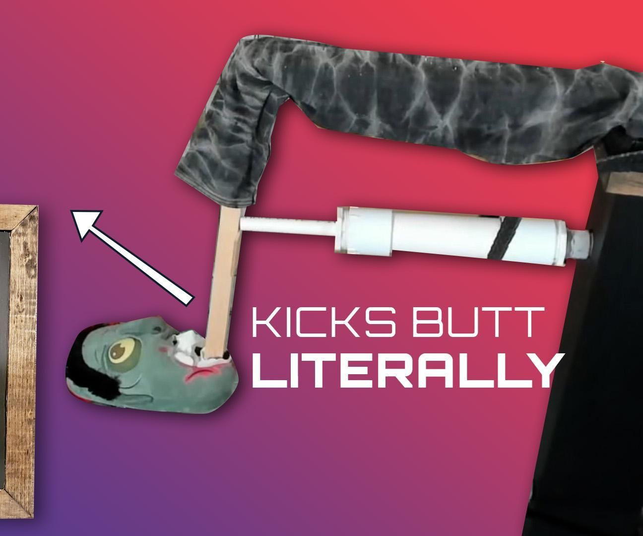

Because this is going to be part of a larger build, I made a nicer looking container for it out of wood. I ended up painting the exposed surface of the top plate with chalkboard paint so I could write on it. I used spray adhesive to secure the foil to the bottom of that plate and trimmed the excess foil off so you don't see any of it from the top.
In my case, the wires from the switch will go to the solenoid of an electric sprinkler valve that will operate a pneumatic cylinder (made from PVC) which will in turn send a piston flying towards a shoe that will kick me in the derriere if I don't stick with my goals! LOL!
