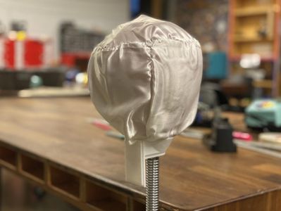

Pressure Puncher was created with the intention to help users—with the focus of students—deal with or relieve their stress, similar to squeezing a small stress ball or fiddling with an object. With the Pressure Puncher, it is a ball that is punched to help people release the anger built up inside them but can also be seen as a playful toy to entertain people. As a result, the punching ball will give users a response through an output of light and sound.
The Pressure Puncher is configured in one mode, the Arduino program will display an array of colors from the LED strip and play a collection of sounds. After every hit, the LEDs will light up in rainbow colored order. Additionally, after the user hits the punching ball, an array of different sounds (ie.a spitting sound as if in a boxing rink or a hurt sound from the game “Minecraft”, a military voice, a random sound or an encouraging applause) will be played from uploading wave files onto an SD card depending on the angle at which the punching ball bends, different wave file will be played.
The difference in angle is detected through the microcontroller used in this project. With the Arduino Nano 33 IoT, the microcontroller has a built in gyroscope and accelerometer where it automatically detects the tilt from a horizontally level position. The angle at which the microcontroller can be observed through the serial monitor on the Arduino IDE.
The main components of the foundational structure of “Pressure Puncher” is a punching ball purchased from Amazon, a customized white cover, sewn together from a silk pillowcase, to contain the LED strip on the exterior of the punching ball, and synthetic filling so that there is protection from punching the LED strips and secure LED strips from falling off the punching ball. Furthermore, the Pressure Puncher has a customized 3D printed part that holds the physical punching ball on top of the spring component in the assembly and also houses the electronics in one region of the project. With respect to the physical construction of the Pressure Puncher, the materials used to build the electrical aspect of the project are an Arduino Nano 33 IoT, a microSD card and reader, a Neopixel LED strip, and a speaker. All the electronics are all soldered to a small rectangular breakout board. The microcontroller is soldered to the top side with connections made to power, the LED strip, the micro SD card reader and speaker—attached on the back side of the breakout board. The LED strip sticks to the outside of the punching ball with an adhesive and the speaker kept on the outside of the punching ball connected to the spring with a built-in magnet to the speaker. With respect to the computational construction of the program, the lights are displayed through arrays based on the number of LEDs on the Neopixel and based on the angle/rotation of the microcontroller. Sounds are displayed through arrays, wav files being read through different functions opening and closing the SD files, and a boolean function to tell if the punching ball was hit.

As the final presentation, many students found this project to be a unique and interactive project compared to other students project. Most students enjoyed the punching aspect with a funny sound that played after hitting the punching ball. Some feedback that the students noted and received that could be improved were the sounds played after the punching ball detected a hit weren't very loud (potentially from not using enough power through the microcontroller), ideate a more unique and novel LED display rather than just a strip around the circumference, and revise another iteration of the enclosure to the breakout board where it wasn't so bulky and could potentially be housed inside the punching ball instead, in which the students could improve with more time allotted.
Step 7: Conclusion
As the final product, the students were able to add multiple sounds to when the user hits the Pressure Puncher.
Some of the issues that the students ran into were not being able to upload wav files to their first SD card and could only be read but not written, the sounds played from the amplifier were broken and unrecognizable after the files were uploaded, there was an overload in the code making--memory corruption---the sound lag and the LEDs flutter, animations in the LED also caused the sounds played to slow down, the students didn't take into account how large the protoboard was going to be when placed in the enclosure, and the pillowcase slowly started coming out from the 3D printed enclosure since it wasn't secure enough.
The modifications that the students made were to add a starting noise while in the idle, simplified the code to combined the sounds and the same colored LEDs in two separate arrays to be played one after the other, taped the LED strip for extra padding, and taped down the pillowcase so that it didn't show the red punching ball underneath.
