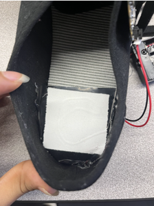

Step 1: Making Velostat Step Sensors
Cut a heel-shaped piece of velostat and tape a loop of conductive thread to it. Make sure the conductive thread has at least an 18-inch tail sticking out from one side. Cut another piece for the other shoe and repeat.
Flip both pieces of velostat over and tape another loop of conductive thread on. The tails should be on the same side, but a couple few inches apart.

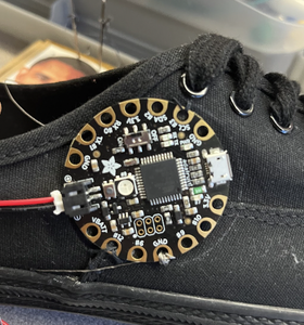

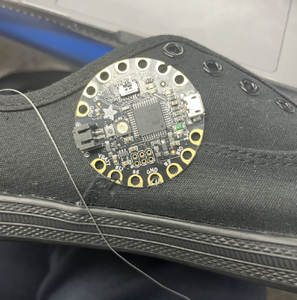

Step 2: Sewing Flora Onto Each Shoe
Pick a spot to stitch the FLORA main board on your shoes. I suggest doing it on the left side of the left shoe and the right side of the right shoe as shown in the pictures. Using regular thread you will need to make sure that the FLORA is secured onto the shoes by stitching through a few pads. I highly suggest using pads D12 and SCl since they are not needed for this project
Make sure to keep the sewing close to the FLORA but even closer to the pads you are sewing into. Doing so will make it much cleaner and more organized.

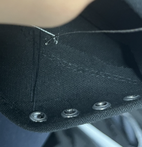

Step 3: Sewing the Sensor Threads
Pick one conductive thread end and thread it through a needle. Pierce the needle through the side of the shoe and near the sole. Repeat with the other piece of thread attached to the sensor. Make sure to keep the two threads not too far away from each other but not overlapping.
Tighten the stitch by pulling it and it should push the velostat into the heel of the shoe. For more stability, I suggest using gorilla glue to glue the sensor to the inside of your shoe.
If your shoes are made of a hard-to-sew-through material, it helps to use pliers to navigate the sewing needle. The bottom soles are much tougher compared to the regular fabric and it is easy to get hurt pushing the needle in.

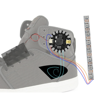

After having both threads sewn in and pushed into the inner part of the shoe, locate the GND pad and the D9 pad on the FLORA board. Sew one piece of thread into GND and the other into D9. Make sure to go through it a couple of times and seal your knot with a "fray check" to make sure it is securely connected.
Referring to the circuit diagram provided by Becky, stitch one of these threads to GND on the FLORA, and the other to D9.
Knot the thread on the inside, seal them with a fray check, and snip off any excess thread.

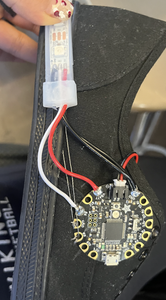

Step 4: Soldering the NeoPixel LED Strip
When ordering the NeoPixel Strips, you will notice there is a diffuser on top. We will keep the diffuser on at the end but for now, you will need to cut a line in the back of the LED strip to take the diffuser off. Make sure the rubber around the wires at the end is also taken off to the best of your ability.
Now looking at the wires you will see three outputs, two wires on the sides of a connector wire in the middle. The connector wire has two wires leading up to the connector portion at the end. With a pair of wire cutters, you will snip the middle connector at the end exposing the two wires we saw before.
The two black wires are ground so you will strip these wires a bit more than the others and wrap them together and solder them onto the dedicated pad as you do for the rest.
Using the image from the previous step, make sure to solder the wires securely into their designated locations. If needed, use copper tape and a desoldering solder sucker to manage any mistakes. Also, avoid touching the soldering iron to the shoe.

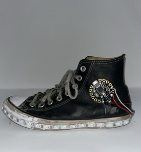

Step 5: Gluing on the NeoPixel Strip

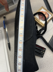

Make sure to sand the surface of the shoe where the LED strip will be and wipe the surface with isopropyl alcohol to make sure it's clean.
Previously we took off the diffuser but make sure to put it back on before gluing the strip onto the shoe. Measure the shoe to determine how long the LED strip needs to be, and cut off the excess.
Put the shoes on and bend the toe part as much as you can. Using a white colored pencil (if you use a black shoe like I did), mark off the section that bends the most. When you apply glue make sure to skip this section.
Lay down a big scrap paper for any mess and put on gloves so you don't get glue on your fingers. It's also good to have paper towels in case of a spill.
You'll need rubber bands and toothpicks to help you glue. Apply a bit of glue to the shoe sole and stick the start of your LED strip to it. Continue applying glue around the back of the heel using the toothpick. Use the rubber bands to secure the LED strip to the shoe as the glue dries.
Remember to skip at the markings. This will make sure the LED strip won't move away from the shoe when it is bent. Otherwise, the sharp bending could crack the circuit board inside the strip.
You will then use the rubber band to secure the shoe as shown above while it dries for 24 hours minimum.

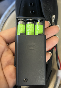

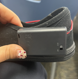

Step 6: Attatching the Battery
Attach the battery to the connector on the FLORA board. Make sure to have AAA batteries available. Since the battery pack is pretty big I suggest attaching it to the other side of the shoe, opposite to the FLORA. Grab some velcro and place it on both the back of the battery pack as well as the actual shoe and make sure there is enough to not have a drooping battery pack.
